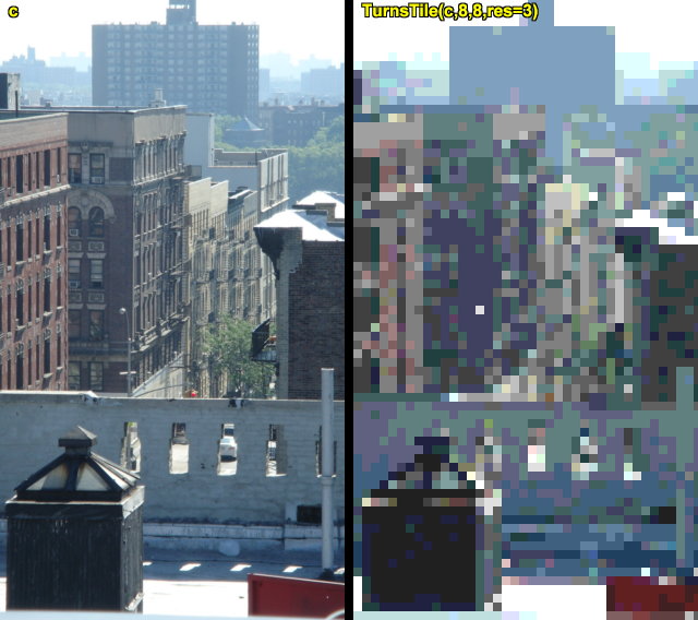

I'm not sure how much I can help you, David, considering both the time since this thread's last activity and the mention of FCP, but anyone else looking for this effect who has access to a Windows installation may get some use out of an AviSynth plugin I wrote called TurnsTile: http://www.gyroshot.com/turnstile.htm
I just finished up version 0.2.0, and it can now accomplish something like what you're after; I can't get the image to embed right in this post, but check the attachment to see a sample. The plugin can't yet apply an actual palette to a clip (for reference, interested parties can find a list of old game console palettes at http://en.wikipedia.org/wiki/List_of...nsole_palettes), but it can cut the image up into tiles while also reducing the effective bit depth of the footage by way of its 'res' parameter.
How do I turn video into 8-bit (Nintendo)-type graphics?-turnstile_tilew8_tileh8_res3.jpg
