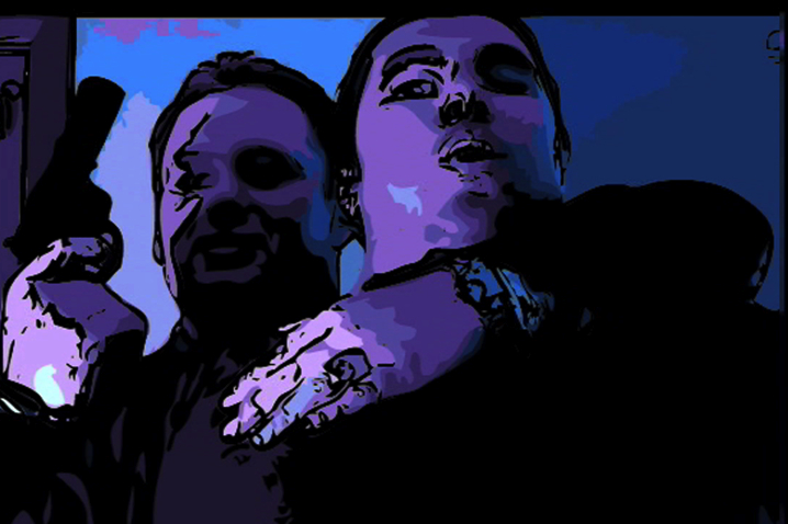

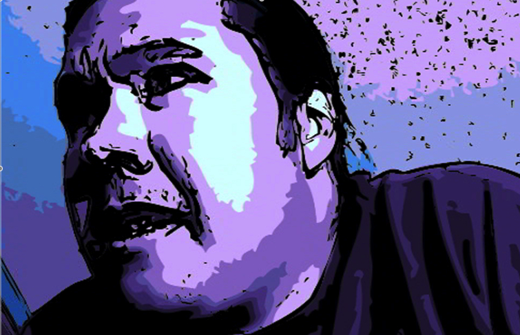

these are a couple of screen grabs of final result, the only thing I did different is that I added a lot of blue tint before I did the steps in tutorial.

The one thing that I am keen to eliminate is the 'speckled' backgrounds you tend to get with these filters and techniques. They tend to shimmer and are distracting. I suspect it's a combination of how you shoot, the settings you use in the AE filter(s) and probably a bit of manual effort too.
Ian Stark is offline   Reply With Quote

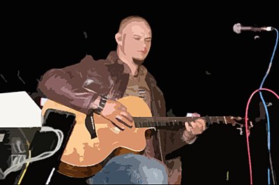

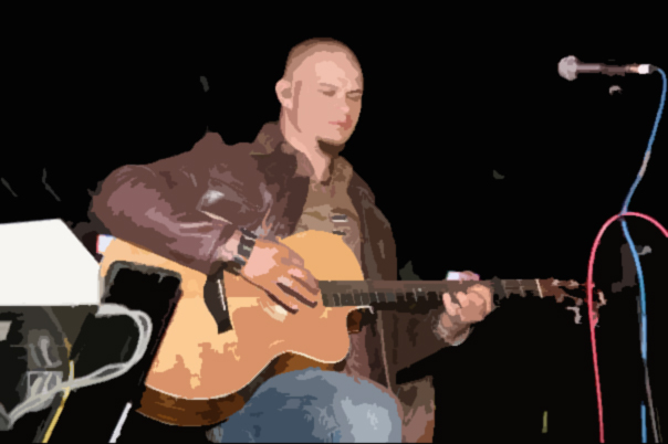

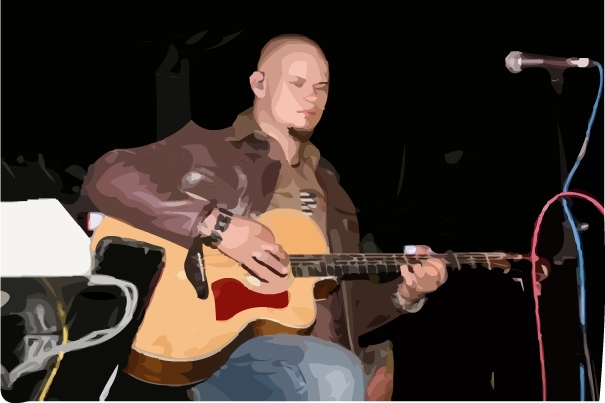

Sure!
Setting Used:
Colour Threshold: 50
Minimum Area: 10/20/30
Curve Fit: Very Smooth
Corner Threshold: Few Corners
Scanner Darkly effect?-flash_test_0.jpg   Scanner Darkly effect?-flash_test_1.jpg

No problems! In answering Aric's original question, yes you could achieve this in Photoshop. The work-flow is a bit annoying, but is a piece of cake compared to using Flash! Photoshop is designed to work with massive files, unlike Flash so it runs heaps better when doing this kind of thing. Personally, if I had to achieve this look I'd probably use Photoshop unless I could find a filter in Final Cut, After Effects or Shake that achieved the same thing.
I've attached an example of what the Cut Out filter in Photoshop looks like using the following settings:
Number of Levels: 8
Edge Simplicity: 2
Edge Fidelity: 2
This method works for both Mac and PC. To "rotoscopearise" a Quicktime movie, open it up in Quicktime Pro and export as a TIFF Sequence. Open up the first frame in Photoshop. Record an "Action" that applies the Cut Out filter using the settings you prefer, saves the file and closes it. Close the first frame without saving. Then go to File > Automate > Batch. Select the action you just recorded, and the folder containing your TIFF sequence. Click OK, go to bed and when you wake up in the morning close Photoshop and open up Quicktime. Open all those newly modified TIFF files as an "Image Sequence". Then export out as a Quicktime movie (matching your original Quicktime movie settings). That's it! You now have a movie that looks like it's been rotoscoped.
I hope this is of some help...
