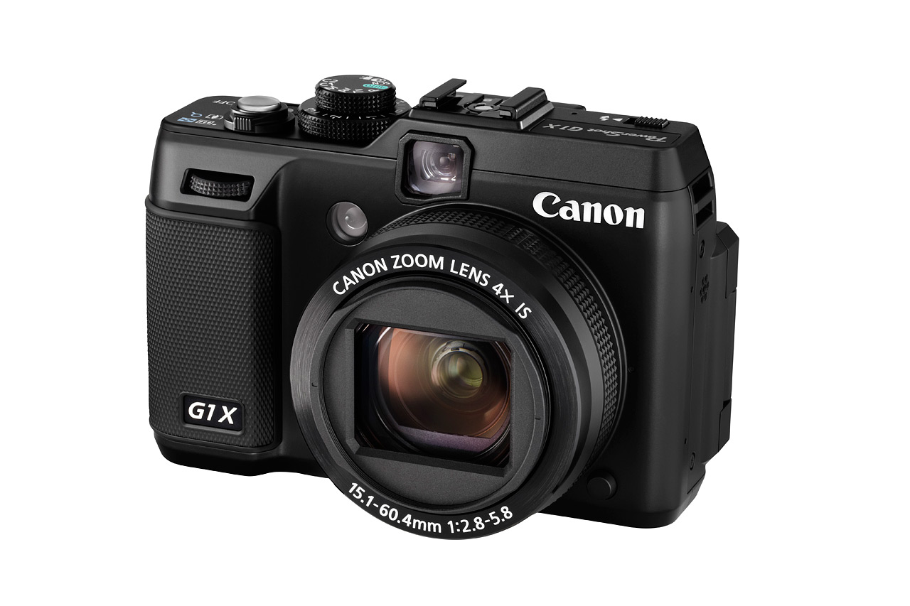

The new Canon G1 X sports a relatively large 1.5" CMOS sensor... 18.7mm x 14mm.
Press releases (with pics) here:
Canon Introduces PowerShot G1 X and Elph 520 HS, 110 HS at DV Info Net
and here:
2012 Canon VIXIA Camcorders Announced at DV Info Net
Canon introduces PowerShot G1 X, new VIXIA camcorders, Elph 520 HS and 110 HS-powershot-g1x_3qtr.jpg

BEWARE THE NUMBERS DO NOT SUM UP
There must be a mistake. From school calculus we know that the hypotenuse of a right triangle can be derived from the sum of the squares of its sides.
18,7X18,7+14X14=545,69 The square is 23,36 millimeters or 0,92 inches!!! Certainly a far cry from the quoted 1,5 inches.
This number can also be misleading, because is the total area of the sensor and not the image area which traditionally is smaller.
Even if we assume that they coincide, we must not forget that the ratio of the sensor is 4:3 and not the traditional 3:2 of photo DSLRs or the 16:9 of HD.
If we calculate accordingly the results are 22,47mm (0,88inch) and 21,47mm (0,84inch)
That must also have an impact on the wide angle coverage, meaning that if the 28 equiv. is for 4:3 ratio, it becomes 29,2 and 30,43 for 3:2 and HD respectively.
For comparison:
micro4/3rd sensor has a diagonal of 22,5 (0,88inch) at the 4:3 aspect ratio.
Essentially Canon introduced its own flavor of Panasonic's micro 4:3rd format.
I just hope I didn't do any mistakes in calculation.

Since the bigger tube was 4/3inch, 1,5inch refers to a tube size that never existed. Amazing!!!

The F5.9, especially in the tele end where DOF is more useful, almost negates the benefits of a larger sensor. I'd rather see a slightly smaller zoom range, let's say up to 90, and an F-stop of 4.5 like the old model.
Nevertheless, for it's size is a very promising camera and I dont think the lack of lenses is important in pocketable cameras anyway.
