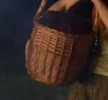

You're absolutely right about "normal" people John, but for me shooting DSLRs moire is *the* issue, along with its buddy aliasing.
The GH2 is the only DSLR I've used to date that adequately suppresses moire and aliasing, and produces a detailed image. I'm waiting for a FF camera that can offer the same detail with good control of artifacts.
There's crazy moire at 3.30 in the music vid... I'm hoping this is something to do with Youtube... but it looks disturbingly like 5DII style moire to me - compression doesn't do this does it?
Ah that it was so simple as avoiding striped shirts etc! :) Josh has the key with the comment about compression.
I heard a great analogy recently whereby moire was compared to food going off (!) Leave some food past it's sell by date and you may get two effects. First is a change in appearance/taste/smell - the analogy here is moire you can easily see with the eye. Second is growth of something which will give you food poisoning - but may not be obvious when you eat it.
And it's the same principle with moire. You can get artifacts which are hardly visible on camera footage - but can play havoc with compression systems further down the chain. Hence footage can look great straight off the camera - but degrade far worse than expected down the production chain. Exactly as some bad food may seem OK to eat - but make you seriously ill a few hours later.
That's why "normal" people DO need to care about moire and food hygiene - even if they don't seem a problem at first viewing or eating!
(If all that seems unlikely, then the characteristic of moire which can cause many problems is that it "ripples backward" in the opposite direction to the object it's associated with. That can confuse coders at low bitrates which use motion analysis - an object can seem to be moving two ways at the same time - and waste bitrate in the coding. Put simply, the end result has the appearance of what it would have been if no moire and a lower bitrate used for the encode.)
