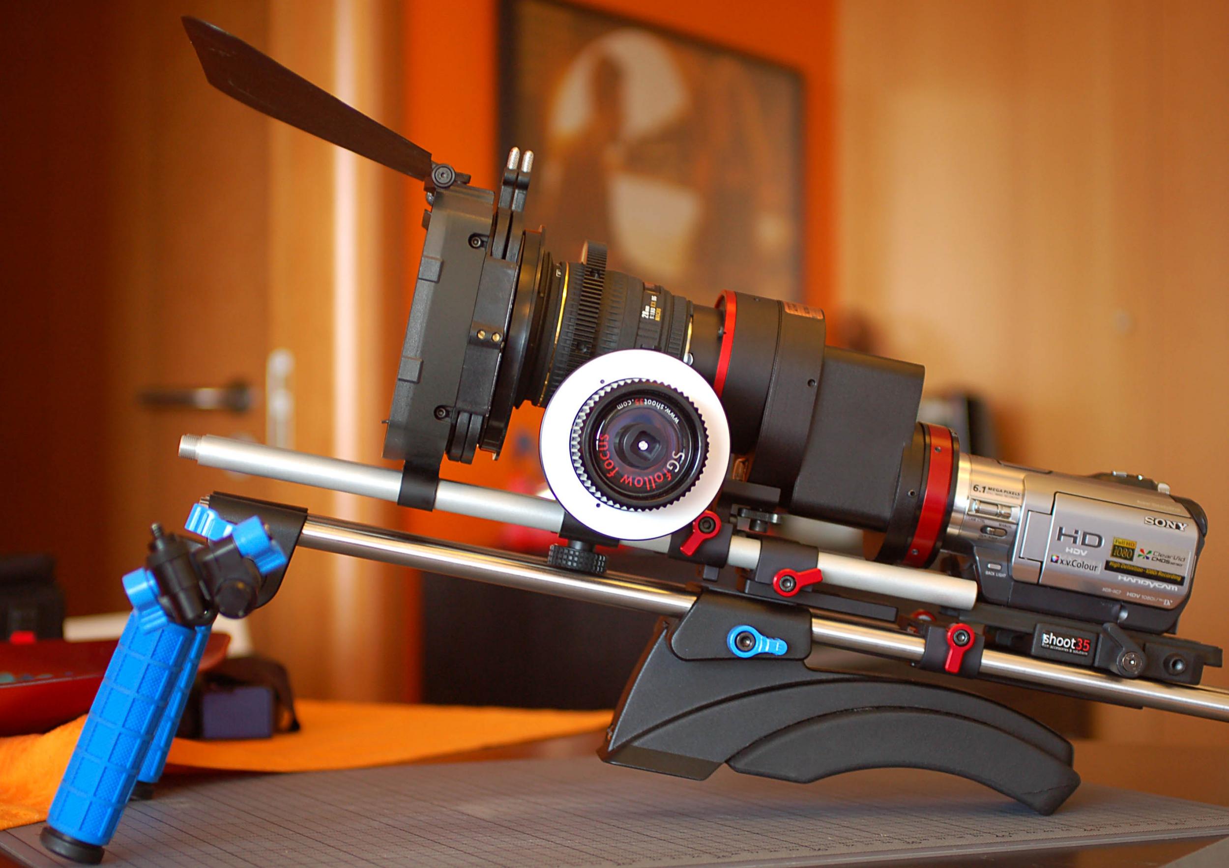

I mostly do docs as many on this thread. I probably was one of the very first XH-A1 owners. I've shot with it many times and guess what... I've changed my workflow inside out and bought a Sony HC9!!!
It was a pain doing shoulder work all day with a DOF 35mm adapter with the XH-a1 and lets face it, no one can distinguish both cameras after finishing some footage (grading it) in post (I've asked many cinematographers and no one gave a definitive answer). One thing is shoot some resolution charts, another is distinguish footage shot with diferent cameras. All comes to play, what is shot, how it was shot, moving vs still shots, and the list goes on and on...
My HC9 + new SgBlade + 50mm f/1.2 with rods weight 20 grams more than the XH-A1 alone! My Follow Focus unit and GearDear Mattebox (which is the lightest MB on the market), adds only a bit more to that.
About focus problems.
It's a matter of experience and no one is going to shot with the lens wide open (at least most of the times where you have light, and I hope you have). One of the smarter moves here - that I've learned with time - is to have an assistant to light darker scenes with a chinese lantern for you. Your assistant can run it with a battery belt on the go, and you always will have perfect lighted "dark" scenes.
If you know your lens, you can stay within the limits of DOFocus (attention! I'm not talking about DOField, but DOFocus which is different!), and obtain a shallow DOField as you would.
Sound is very important on every film. I would not advise anyone to bugdet this part of the system. I'm a very lucky man because my wife is my sound operator. Our sound system is based around a Tascam HD-P2 with a SD Mixpre feeding it. We currently have a great workaround to have everything in sync and it's called TTL. It's a gadget that transforms the HC9 LANC signal to an TC LTC signal. We run a cord trough the HC9 feeding the Tascam and everything is in sync in post. It's a breeze working like that.
Besides that, the small weight of the image system (HC9+SgBlade+Lens+Rods), make it possible to work with the most reliable and best "budget" tripod on the market with a truly fluid head: Sachtler DV2.
My XH-A1 is reserved now mostly to fiction films which aren't 90% handheld dependent like my docs.
I can say that buy a smaller camera to work with a 35mm adapter was one of the smarter moves that I've made in the film documentary to date!

Thanks for that post. A couple of questions:
1. Do you have a picture of the actual setup ?
2. DO you have footage on Vimeo to see the results ?
3. How do you manage white balance, ND filters, manual IRIS, Zebra, Peaking, Battery hours (some days I shoot 6-7 hours straight) and all the other regular stuff you find at least on a Z1 ?
I'm very curious !

Hi Francesco. I'm going to answer by topic. Here it goes:
1. I don't but I can take some. I will try to post them tomorrow.
2. I don't have footage on Vimeo. I'm not even registered there. All my films are copyright protected by the Portuguese Author Society because they have to, as is part of the contract you make with the Portuguese ICA - Instituto do Cinema e Audiovisual (Cinema and Audiovisual Institute).
I'm planing to do some shots to post somewhere though, just to show the potential of this configuration. I'll do that when I have some more spare time, which is difficult right now. I'm going to start shooting a new Doc this summer with this setup. I will post some not used shots.
3.
About WB. The white balance on the HC9 is set as every other prosumer camera on the market. You can choose between Auto or "One Push" (Manual). You can even set the Auto function to Indoor or Outdoor use. One Push lets you set WB against a white card.
About ND. Simply put the filter on your Mattebox.
About manual Iris. You can either choose Auto or Manual. Obviously, I always choose the later. I attach my SgBlade, zoom the lens on the GG and choose an f stop around f/5.6 most of the times. I always have Sony's Cam Control Dial set to Exposure, so when the light becomes dimmer I open the Iris one or two stops. Knowing out to control the Iris without messing with the Auto Gain feature is very important tough. It toke me many ours to investigate and many others to experiment and put it to work. If you care, I can share the info with you. Just ask.
About Zebra and Peaking. Those two are features that you can encounter on the HC9.
At last, battery hours. The Sony NP-FH100 is a 3980 mAh battery, so compare it with your EX1 6600 mAh BP-U30 Battery and you are going to see that you have a 2620 mAh advantage.
The thing is that your EX1 consumes much more energy than a little HC9. I've been reading EX1's manual and your camera consumes 12W on a typical recording when HC9 consumes only 4W to do the same. Guess which is getting the advantage here :)
Hope this helps.

Thanks Nelson
Very curious to see the pictures of your setup (to understand the size and usability) and the outcomes on video !

Hi Francesco,
Sorry for the late answer but I went on vacations and only arrive yesterday. Here's a photo of the setup. Bare in mind that the Mattebox shown is not my Geardear (loaned at this time), but a Century MB44 one. It weights about 400 grams.
I've weight the setup that I'm posting here with all that you see there. Camera with battery, SgBlade with Flip, Shoot35 and RedRockMicro Rods with shoulder support, Sg Follow Focus, 28mm f/1.8 (so a very bulky lens), and the Matte Box and it came out weighting a total of 6 kilos. About 13 pounds.
Hope this helps. Cheers
HD / HDV documentary equipment choice help-sony-sgblade.jpg
