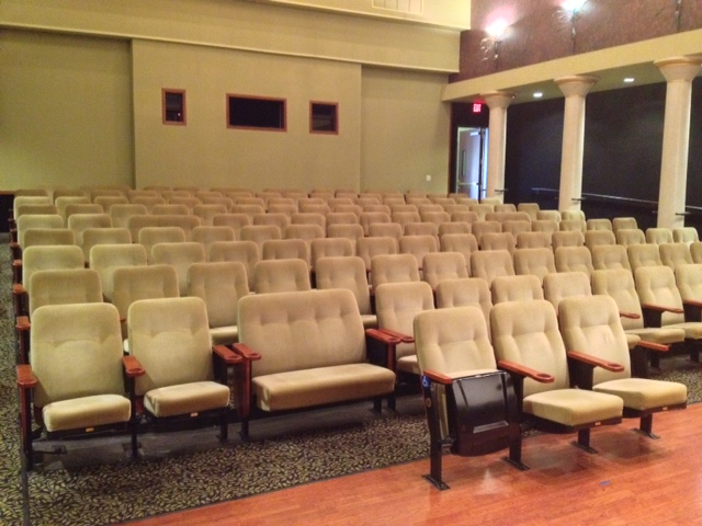

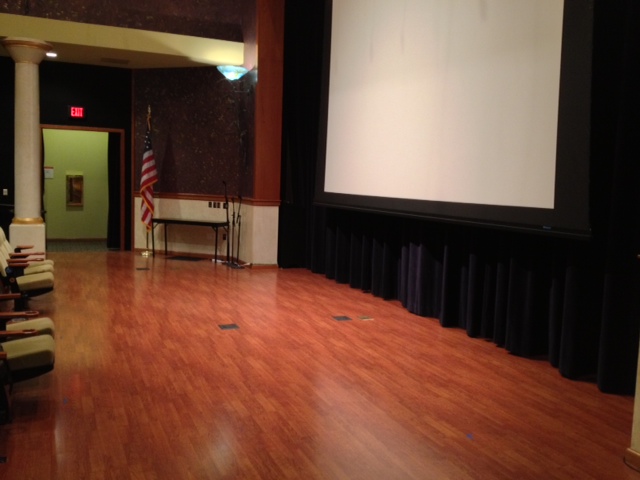

John - I don't have the opportunity to do the interviews at their homes, unfortunately. I am shooting at a movie theater in a retirement community. I was planning on setting up the camera and backdrop on the main floor in front of the screen. I could also shoot into the seating section without a backdrop, I just don't think it does much to tell the story. (see pics)
I will indeed be including photos and shots of momentos. Didn't think about family. That might be a nice touch.
As far as interview approach, I have done phone interviews with each subject as a way to filter the ones I'll be interviewing. I'll use those notes as touch points during the interview. I noticed they are quick to describe details like rationing and other external things that they witness, but I also want to get to know how they felt. What did they feel during air raids? Some have said they thought it was fun. They were kids after all!

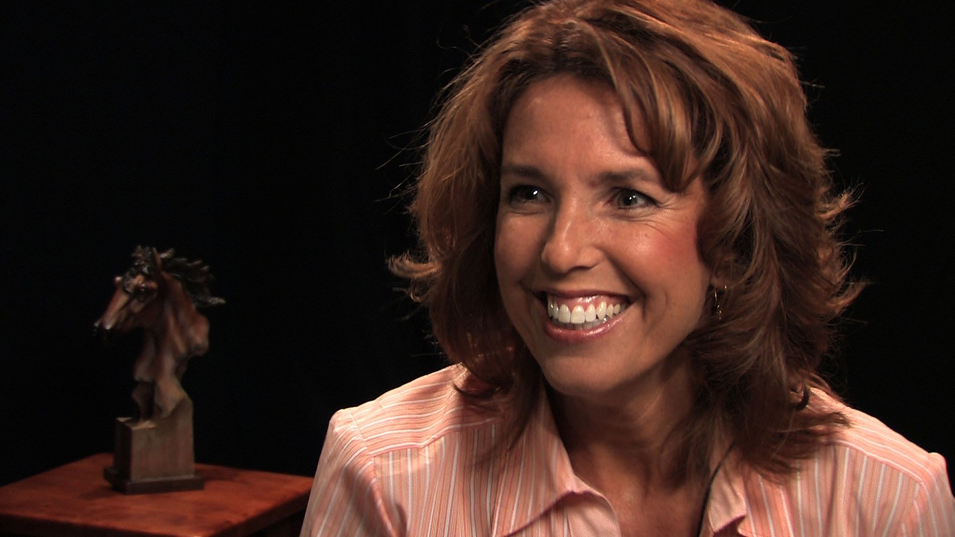

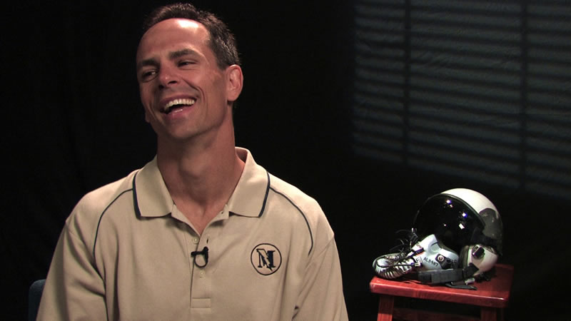

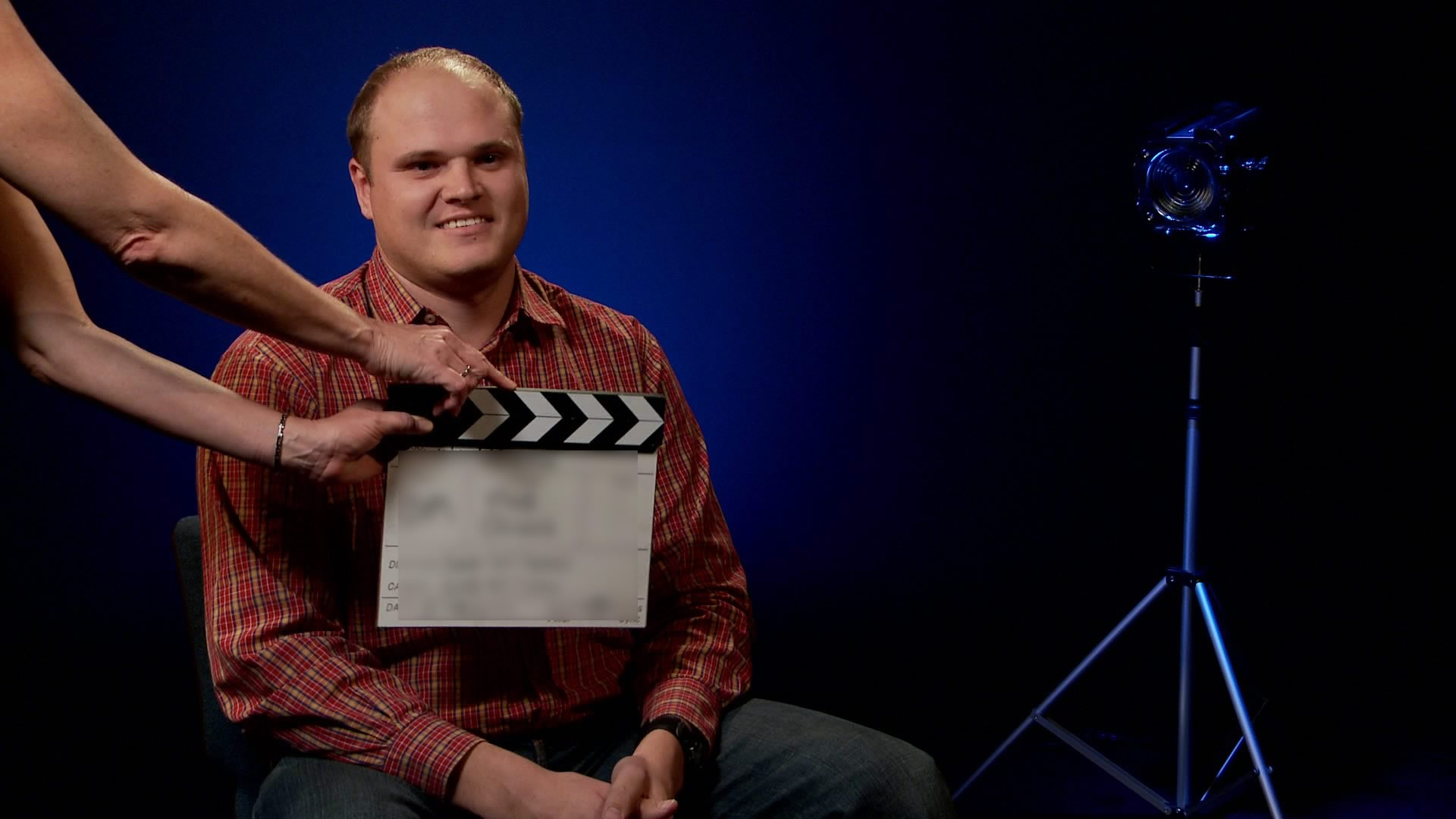

The black void is, I think, pretty timeless. Backdrops aren't too "in" these days. You can work with the existing black curtain and add another wall to create a corner so your second camera also has a black background.
If you go the backdrop route with stands and everything, plan on lighting the background. A nicely lit subject and an unlit backdrop is not desirable. In the black void, I have added a lit something-or-other artifact in the background and swapped artifacts for each speaker... the black void helps a lot. Also, you can blast a color behind the subject on the black background. In my case, it's a Lowel Omni 420w with a Rosco 80 blue gel. The wall was painted black. YMMV

You've got a nice location to work with, how about shooting with the columns and American flag in the far background, each one spotlit. It's a bit abstract for this doc, but wouldn't necessarily be out of place. Probably a quick setup too.

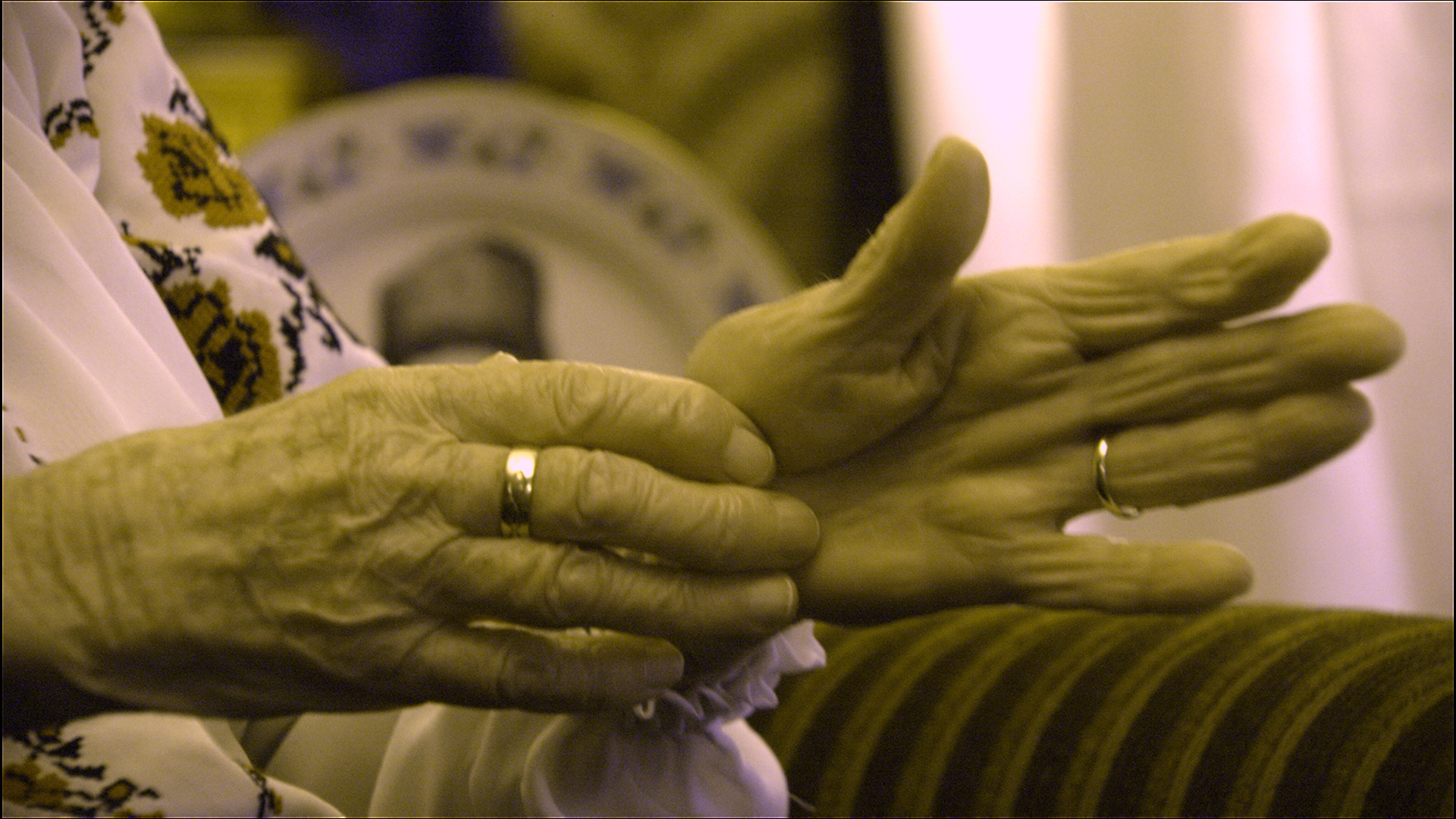

For a series of five oral histories on the Holodomor ( Ukrainian Genocide ) we were more fortunate. Four were conducted within the interviewees own homes and one was done in a church. We found that everyone's own little personal stamp on their living space was evident in some form, a small vase, a family photo, a plate on a small wooden stand, religious icon. In the interview, the attached frame grab refers to, the significant personal object in this instance was a plate visible in background which bore the hand-drawn image of a Ukrainian hero or cultural entity.
You might therefore enquire for some personal item to be brought along that might also symbolise the individual as a backdrop item in the otherwise neutral background I guess you will be using, judging from the other advices you have been given above.
