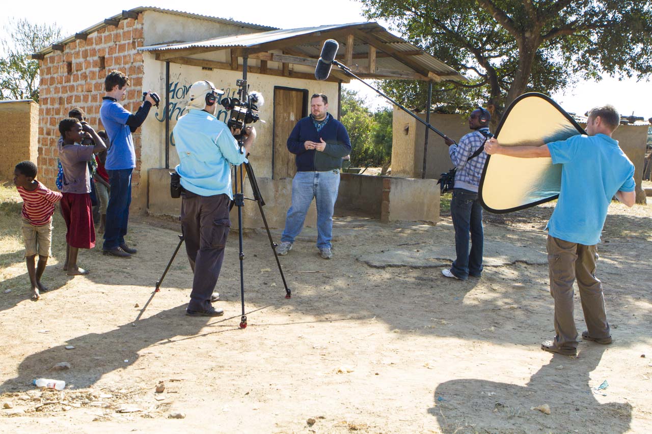

My first reaction to this was "if you don't know, maybe you shouldn't do it". But we all get started somewhere.
I have done several of these but not for broadcast so for what it's worth:
a) The smartest thing I ever did was invest in crew members. It doesn't take long before they know what to do the moment we pile out of the vehicle. In this case, my co-producer ran the reflector and helped with the interview.
b) I use a wireless link from the soundman's mixer into my camera.
c) I also invested in the Edlekrone handstrap for my b-cam operator with a DSLR to improve stability of that camera as it's always handheld. YMMV
d) I love the K-Tek KE79CCR Avalon as it fits in luggage, internal cable and side connection. Ditto the Rycote S-Series Blimp as it comes apart in a flash and travels well.
e) A wireless lav goes on the fixer or subject matter expert and another on the translator (into a second channel in the field mixer with Tascam dr-40 recorder).
f) Camera shotgun for backup and anything too fast or small for boom.
g) Attached photo is just up the road from you in Zambia. haha.
Equipment for wildlife documentary/reality footage-img_4936_md.jpg
