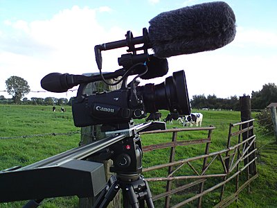

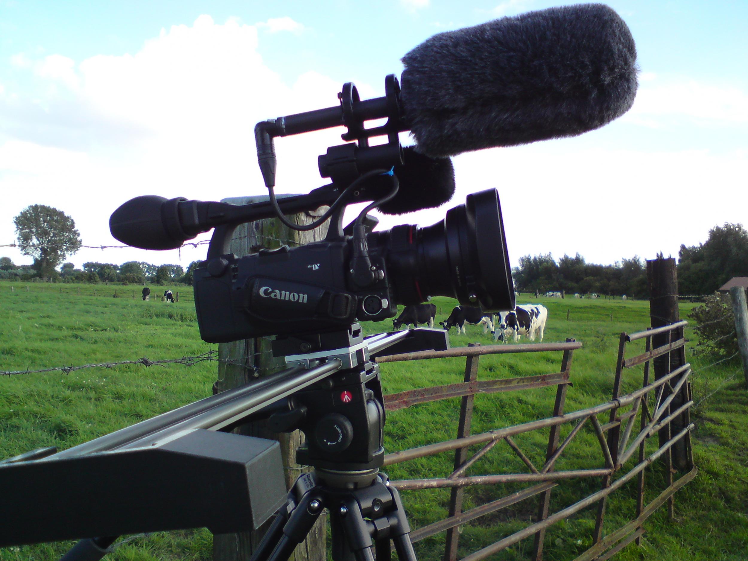

Nice video. That's exactly the way i shoot with the glidetrack i bought recently.
The main reason for that is that i only have one tripod at the moment. And i need to buy a cheap second head to put on top of the track.
On top of my 503 head it ads a little bit of instability, the head 'wobbles' a little bit on the extreme sides of the track. But it is really easy and fast to setup for some dolly or truck shots. I mounted a Manfrotto 577 quickrelease under and above the track. It's a matter of seconds before i can go.

why not putting an extra leg with a cheap monopod.
of fixing a bar between one end of the rail and one leg of the tripod.

Yes, that's possible.
I'm actually thinking about buying a dedicated cheap tripod with head and to use this setup for the really quick ones. Also, when i have to walk with my gear, another monopod or bar will be to much. This is already a pain to drag around.

Hurbert- just out of curiosity, whats that on the front of the lense of your a1?

Hubert:
I too have been contemplating buying the GlideTrack. How do you like it? is it smooth throughout its entire range? The way you have it setup, can you pan the head while sliding the camera?
Let me know.
Thanks so much!

It is smooth all the way. But i like it better with some weight. With the XHA1 on top it is easier to control than with the small HV20.
It is possible to pan, but i don't use it that much. It is better to support the end of the track with one hand and to glide with the other. You can pan the head by pushing the end of the glidetrack, but you have to be carefull not to unscrew the track from the tripod-plate. You can make some crane-like shots when the camera is on one end of the track while panning.
Tilting can be done with the camera in the middle of the track, once you get to one end of the track the glidetrack wants to start screwing tighter/unscrew itself from the tripod. It's just because it isn't designed to mount this way. With the track mounted on legs and a head on top you don't have these problems. I just like the flexibility mounted this way.
On normal use the track doesn't move on the plate. Maybe i'll drill a VHS-adapter hole in the track to stop it moving when tilting.
