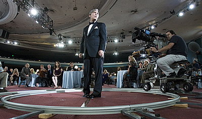

I will echo Nate's point. The only time we tend to use curved track is for 180 to 360 degree shots, basically never for slight curves or arcs. We DO use dance floor for those, which is something that is virtually unknown in the indie dolly market. I'm wondering how long it will be until someone develops a low-cost crab dolly that will allow for this (i.e., four-wheel steerable).
Definitely move forward with your straight dolly, and if you have access to Steadicam, use that for compound moves (or handheld).
Just for fun I attached a picture of the last time I can recall riding on circular track--picture is dated 9/06. That's tight-radius track in use. If memory serves I had to keep the lowest possible profile to avoid shadows on Mr. Malkovich, hence my scrunched-down appearance, and the back-mounted mag. My focus puller was working remotely.
