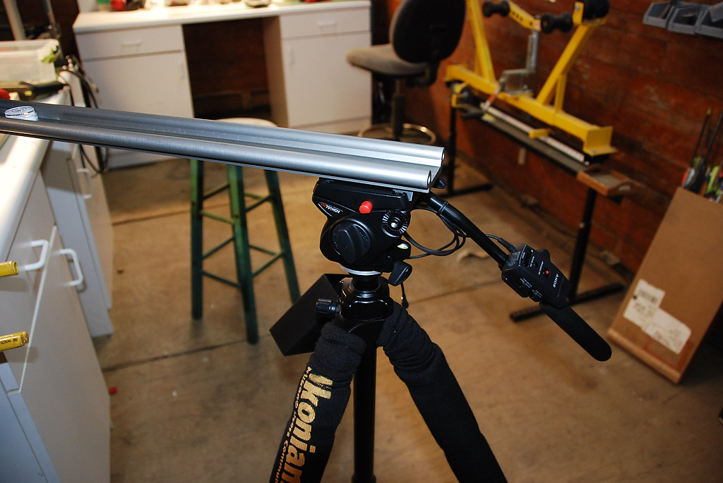

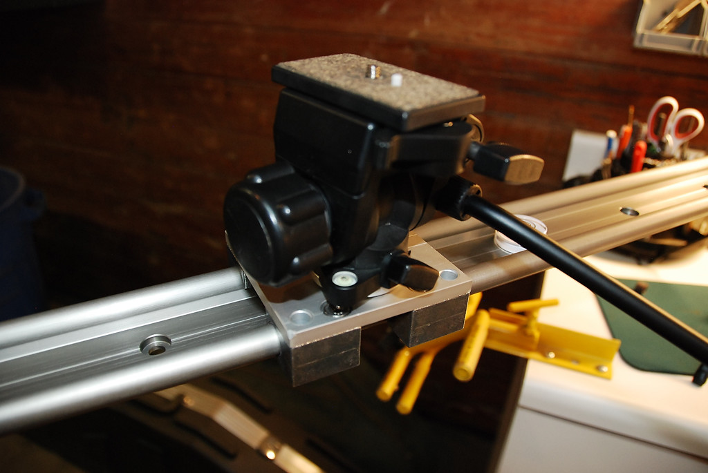

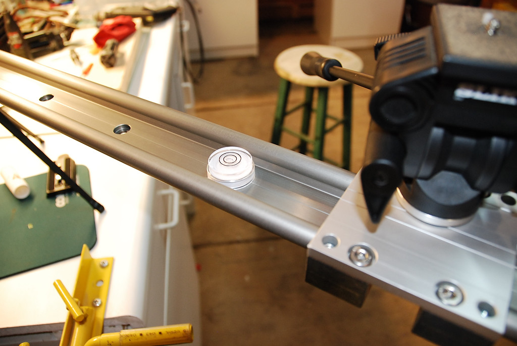

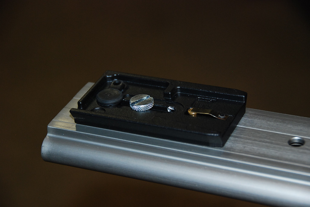

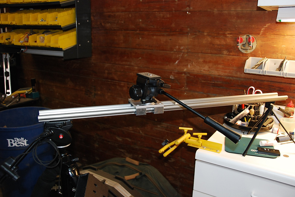

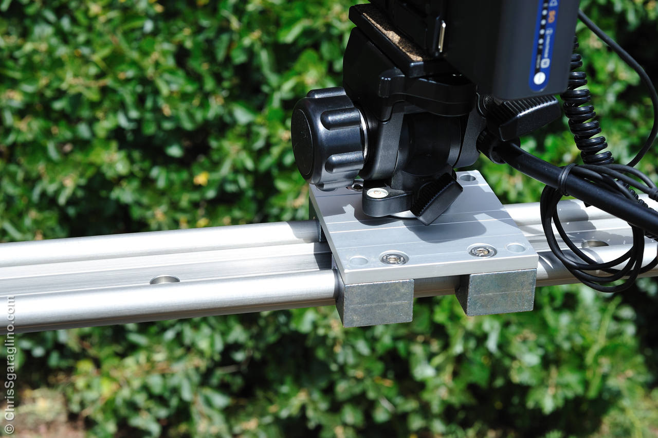

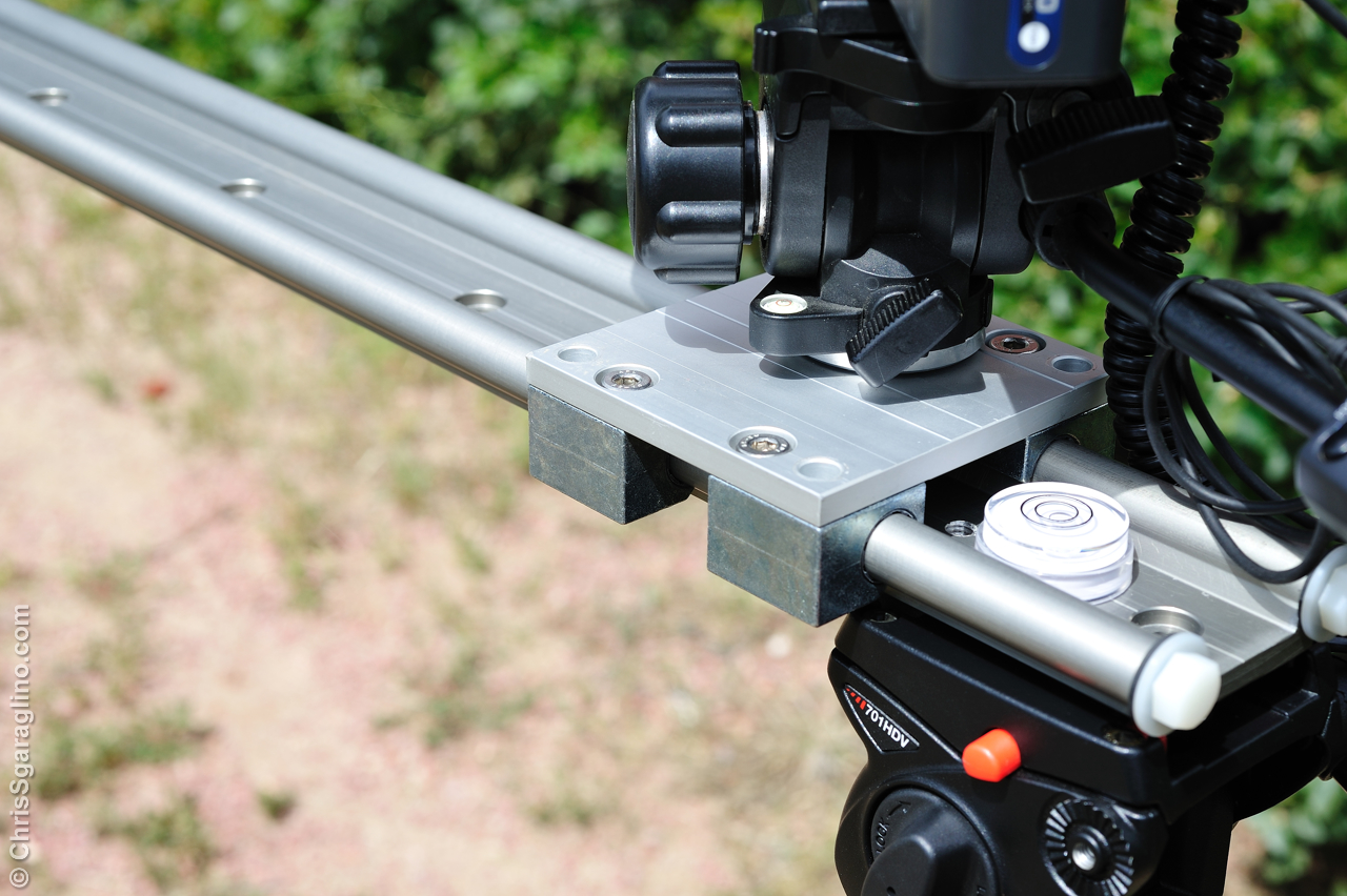

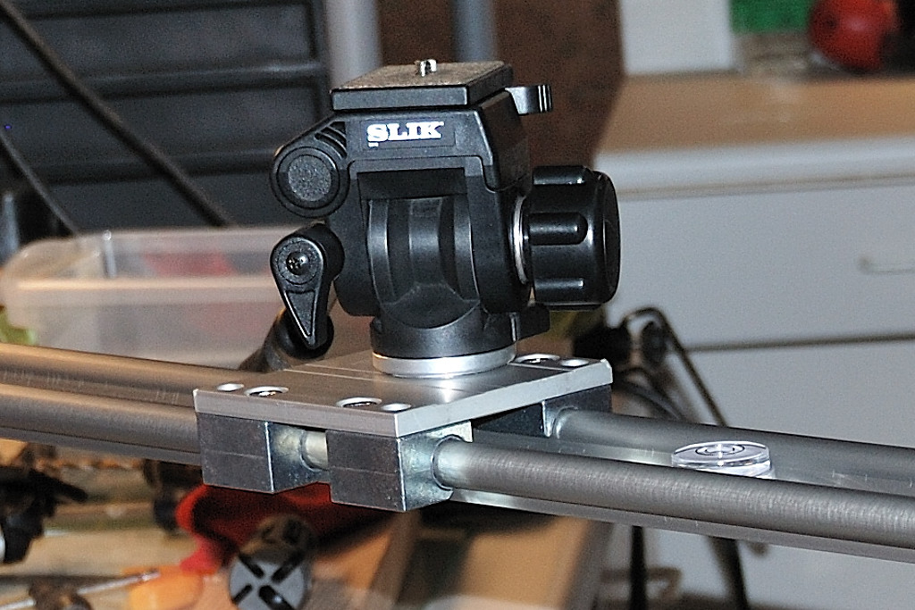

So I got my slider for under $200 - actually just over $160, and it only took 15 minutes to put it all together.
Here is what I did...
I ordered:
1000 mm (40 in.) of 60mm wide rail WS-16-60
1 shuttle number WW-16-60-10,
Igus Rail Description: Rail: 9 mounting holes, 120 mm apart; Dim C5/C6 (first/last hole to end of rail): 20 mm; bolt size: M6
From igus, Inc. - Website, Latest News & Contact Details. Products inc. cable carriers, plain bearings, linear guides, high-flex cables for automated machinery (just call 1-800-521-2747), other lengths are available.
Cost: $158.38
From Home Depot I bought a circular level ($2.35) and a 1/4-20 x 1" bolt ($0.35)

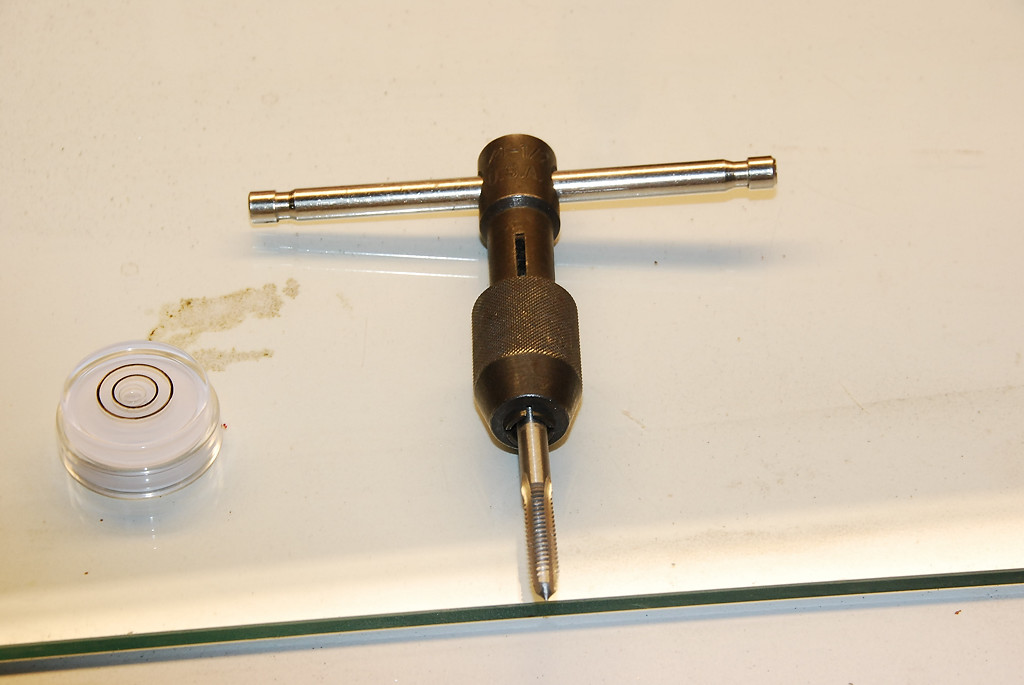

I drilled the shuttle with a 13/64 drill bit off-set from the center, and tapped the hole with a 1/4-20 tap, and screwed in tight the 1" bolt. This bolt will hold your video head of choice.
Then bit & tap can be bought from Home Depot cheap.
I drilled my shuttle off center because I wanted room on the shuttle to mount an cold shoe bracket for lights, filters or additional sound.
I then drilled and tapped each end for 1/4-20, the same size as my tripods & monopod.
I mounted an additional head plate for my 701 (main) on one end and I can use any assortment of mounts on the other including a light stand. I can even add a couple of table top tripods for short legs.
So three holes in 15 minutes and I am ready to go.
A very thin layer of epoxy on the level and stick it right in the middle of the rail.
I'll be shooting in the Colorado mountains next week and I'll posts some clips then.
I hope this helps...

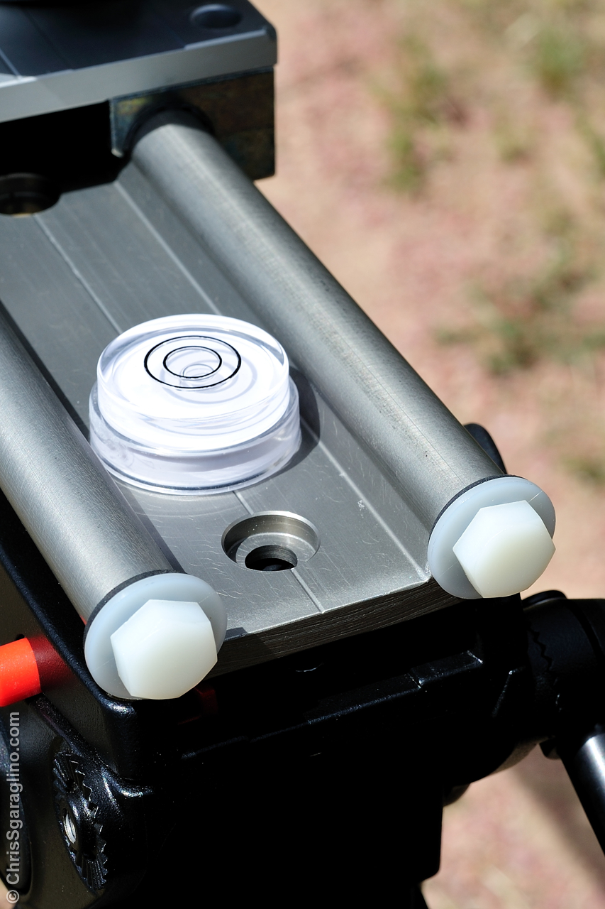

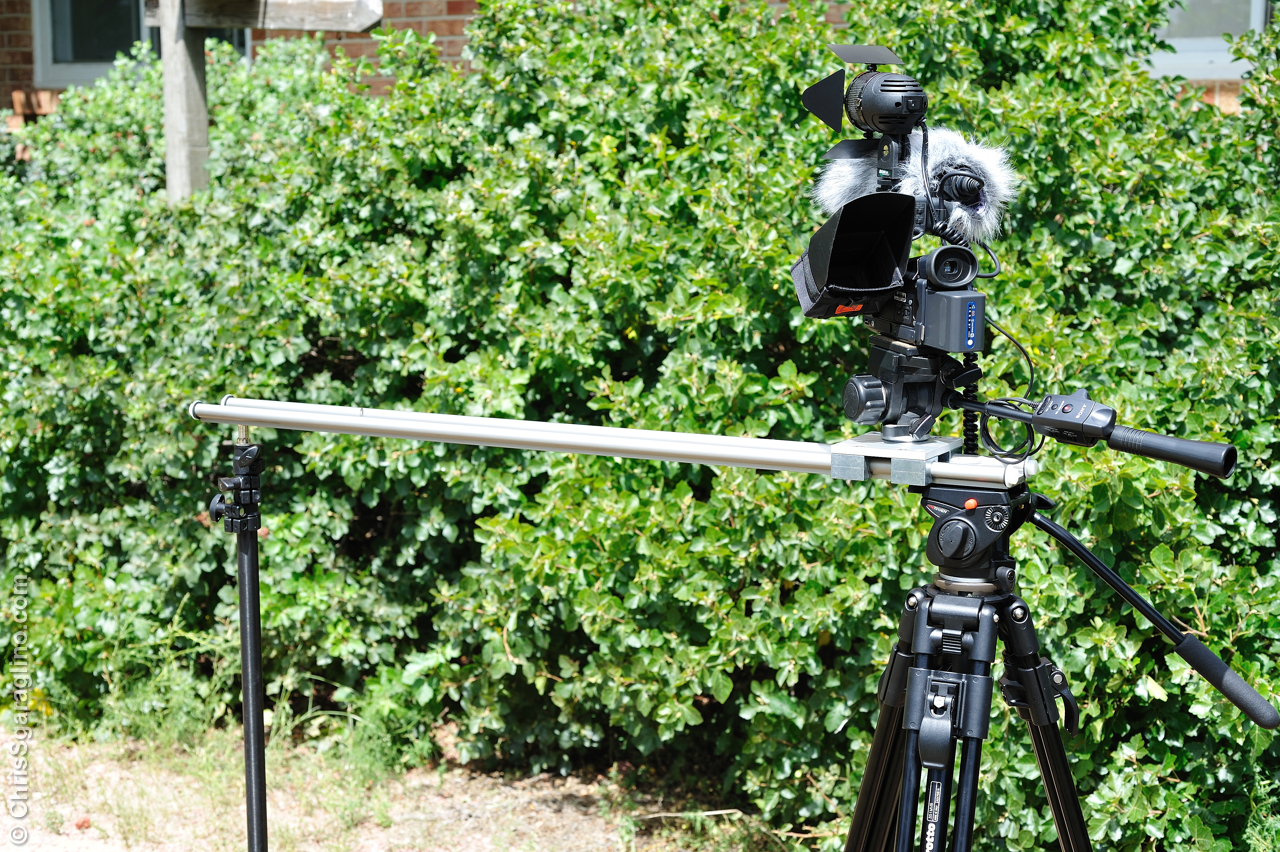

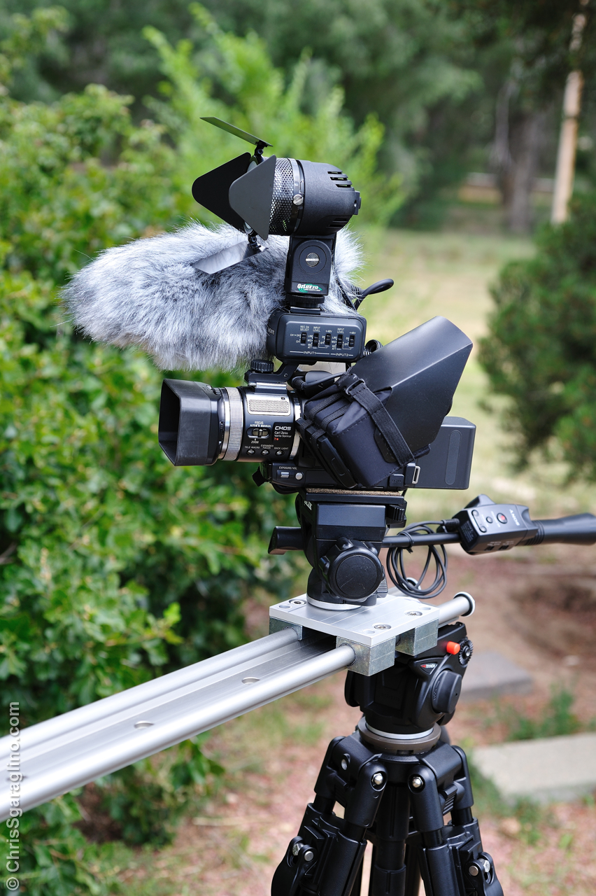

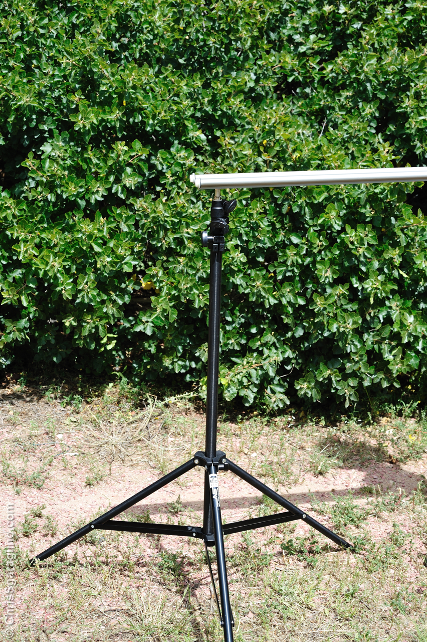

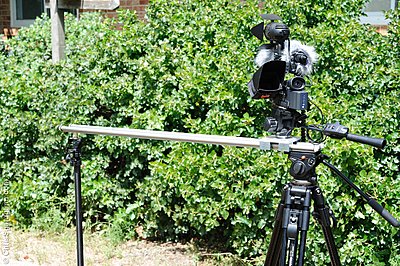

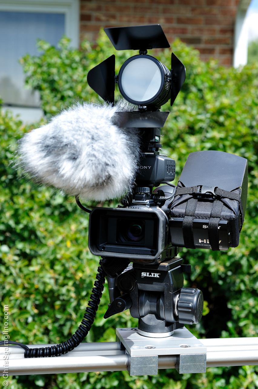

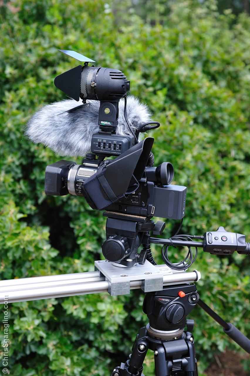

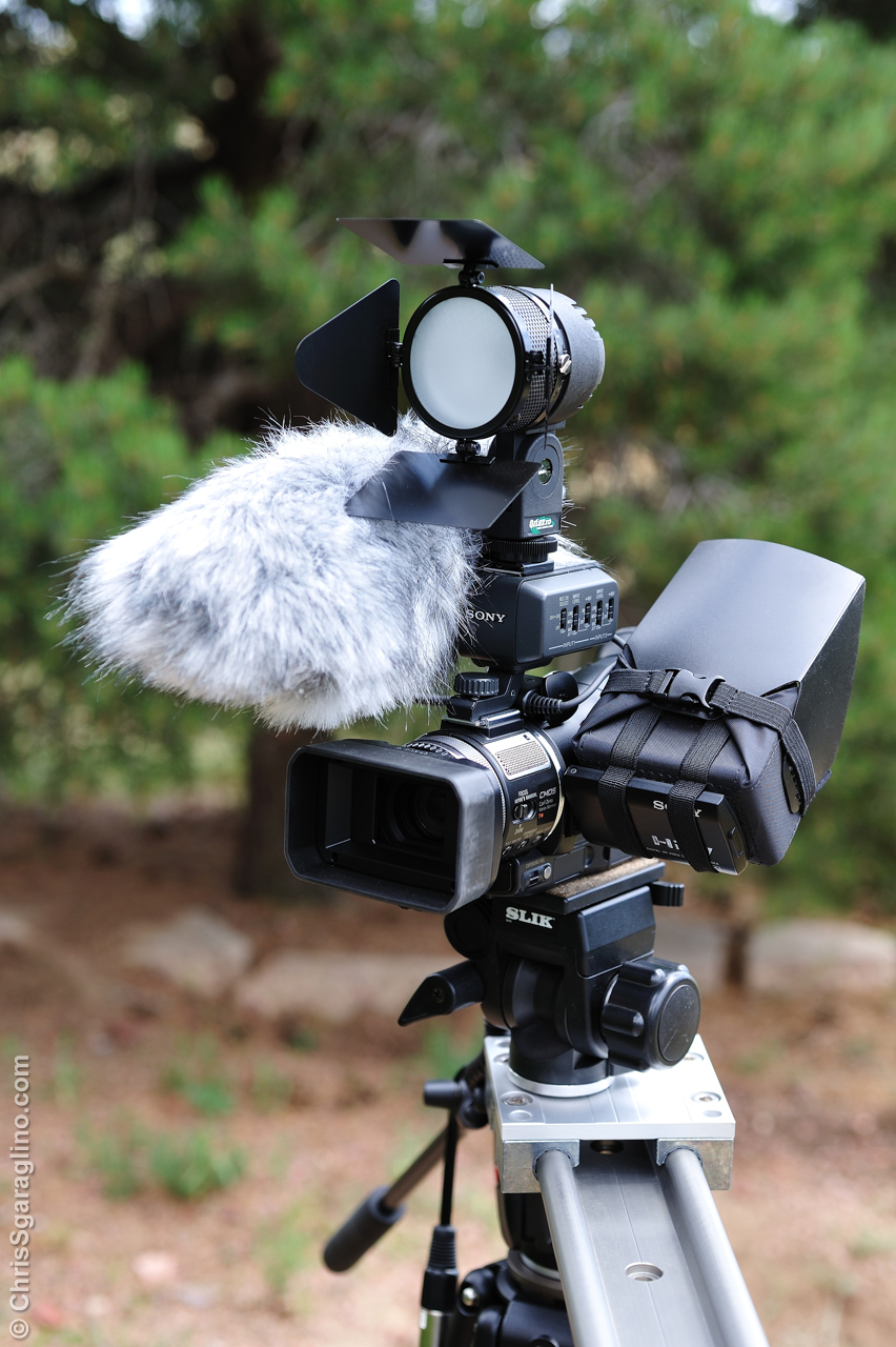

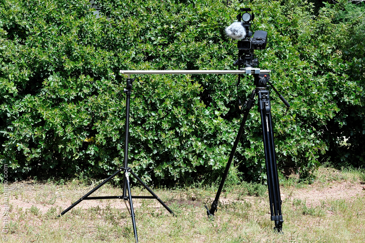

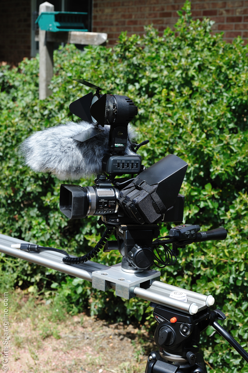

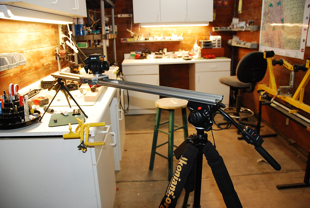

Ok I went ahead and added some end caps by using nylon bolts & washers and a rubber washer from Home Depot. This keeps the carriage from sliding off the end.
Also here are some photos in use.

My system with the small Slik fluid head is right at 4 pounds total weight.
