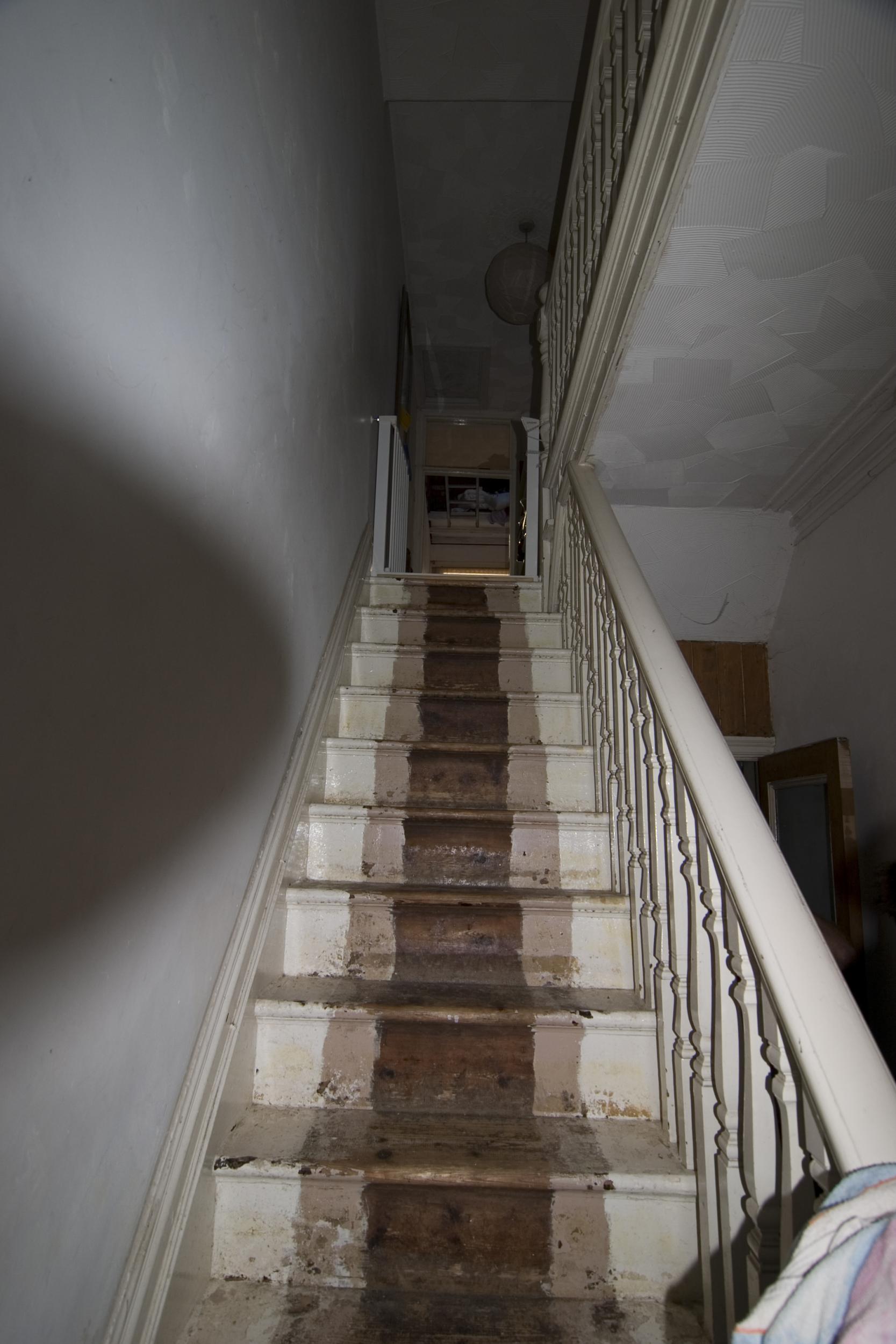

Just wanted any ideas of how to achieve a continuos dolly shot moving up a staircase. I want to dolly up a straight flight of stairs in order to compose a shot of people walking up with faces constantly in frame. Hope that makes sense?
The camera is a canon 5d, so no huge weight issues there, and was trying to figure out what kit would best suit. I was thinking either some kind of narrow dolly (the staircase may not be too wide, location pending) with some kind of leveling aspect (ie a tripod sitting on some wheels, with front leg extended to compensate for the angle of the stairs) or something that can be attached to the bannister and slide up that way. Does anyone have any ideas what kit would be viable either to buy, and thus not too costly, or rent and subsequently not too uncommon, giving me a chance of finding said kit in a rental house.

I imagine you have a reason why Steadicam is out of the question, as that is obviously a simple way to achieve this shot.
Keep in mind with whatever you rig: anything in the center of the staircase (track etc), the actors will have to step across. Another rigged to either the center or off the banisters will eventually be revealed in the frame as the shot continues.
Consider also the preferred height of the lens relative to the camera. It's nice to not have to arbitrarily look down on actors when pulling them up stairs (just because the camera is further up the staircase). I've done this sort of shot in low mode Steadicam just to get more into the actor's eyelines--it's a pain to operate but it's an improved angle. This will also help solve the issue above where you will see more of the mounting rig in the background of the shot the more you are looking down at it.
There may be some solution involving a board that straddles three or so steps with a non-binding surface on the back that you could essentially pull up the stairs in front of the actors, but keeping it from wandering left to right would be another issue to solve.
Anything that has the camera simply locked to it will require you to move the rig at a very specific pace as you will be regulating headroom and image size--if the actors change their speed, you have to be able to react very quickly.
Really, outside of an elaborate crane/remote head setup, this is in the domain of Steadicam--although I bet that someone else here will have a Rube Goldberg-esque solution from out of left field!

The reasons for avoiding steady cam have been pretty much covered by Charles. I want the camera to smoothly lower at the right eyeline with the talent in an easily repeatable move. There's nothing quite like a tricky camera move to ruin performances. I also have visions of losing the steadycam operator down the stairs which wouldn't be too pretty.
I had considered a dolly with crane attached, but the likelihood of camera wobble makes this too tricky to pull off.
I'd never thought of using a cable dolly. Any suggestions on a good model? Is there a relatively inexpensive model out there?
I've attached a jpeg of a possible set of stairs.
Thanks very much guys, informative and helpful as ever.

I would personally want to see more pictures of the location before making a recommendation on this. A lot depends on what is just outside the image you supplied. If there's a short foyer and generous-sized front door
immediately in front of the stairs, you could do a crane on track with the fulcrum outside the door; a grip at the front of the arm would guide it down the stairs as the chassis is pulled straight back. A Jimmy Jib would be a good choice for this as the operator would be able to make minute adjustments to the framing.
I'd be wary of attempting a cable rig for a shot like this--those only function underslung, and you want the camera to be up at eye level which would push the carriage up into the header. Also, rigging the tiedown point to the ceiling in the hallway could be a dicey proposition...
Honestly, a good Steadicam operator should be able to manage this and it would be the least amount of fuss (certainly setup time). To get the lens at eye height would require a significantly long armpost and hopefully a tall operator! But it's well within the realm of a good working operator to pull this off.
Having said all this, very often it's not necessary to be right up in people's grills on a staircase. Have them grow into a close shot with the camera static at the bottom; pan them from off to the side (as it becomes about their backs the person who is furthest from camera can be seen in a reverse over, hopefully the lines can be timed out to accomodate this), or even watch them go from behind and just hear the dialogue. Or a combination of the three. There's many ways to skin this cat and sometimes the "easier" shot is that much more effective. The image you sent is of a staircase with a lot of character; it might be more interesting to lay back on a wide shot to feel the surroundings, give the actors some breathing room. Just bringing that up as a consideration.

Quite right, I did say moving up the stairs in the first post. However the gap between my first two posts and my third was used to visit the location and an adjustment was deemed necessary once we saw the layout of the building. Sorry I should have mentioned the change but it's getting a little hectic at present what with preproduction balancing with my day job as an editor.
There is a fair amount of space at the foot of the stairs and then a front door. It might be too long a corridor to do what you're suggesting with a crane. Steadycam might be easiest as you suggest. I was keen to have a more fluid move down the stairs and am not sure a steadycam can compete with a dolly (but thats just my experience).

A long corridor would work even better for a crane, depending on the math (corridor dictates the length of the arm--will that be long enough to get the camera to the first position up the stairs). Easier than dealing with a doorframe in any event.
Steadicam will certainly be "fluid"--unfortunately, depending on the operator that definition may be a good or bad thing (if "fluid" extends to "bobbing in the water")! If you are able to get a great operator, you will be in good shape, it's not that hard a shot for someone with experience. These days there are good operators just about everywhere.
