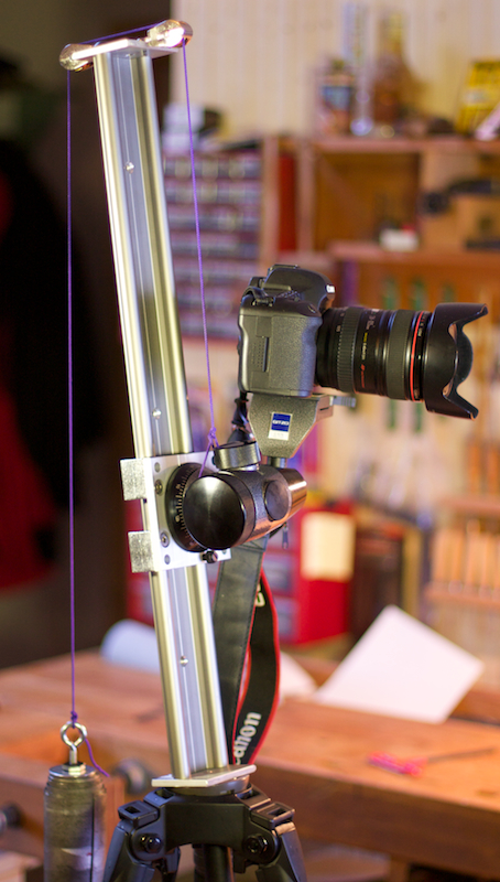

The 701 is a decent head and a very good match for Igus sliders and a 5DmkII. It is light and low with 3/8" threads.
I find that I can pan very nicely with it using "body mechanics". Lets say you start with the camera on the right side of the track and angled about 45 degrees right. Put the arm of the head down so it rests against your forearm as you grip the head in your right hand (right above the carriage is best down low) now as you move the carriage left the head will pan automatically and very smoothly. This can make a slow 16" move look like a 20' dolly move.
Tilts are much harder and I mostly avoid them. Keep your moves simple and slow. As I said above always hold the head right above the carriage, never use the arm to try to pan or slide the camera, this works well on sticks as well, your pans will be much smoother in most situations this way.
I do use a ball head as well often, this makes it possible to do up or down hill moves, I even do vertical moves with Igus track by setting up a counter weight system. Photo of that below.
