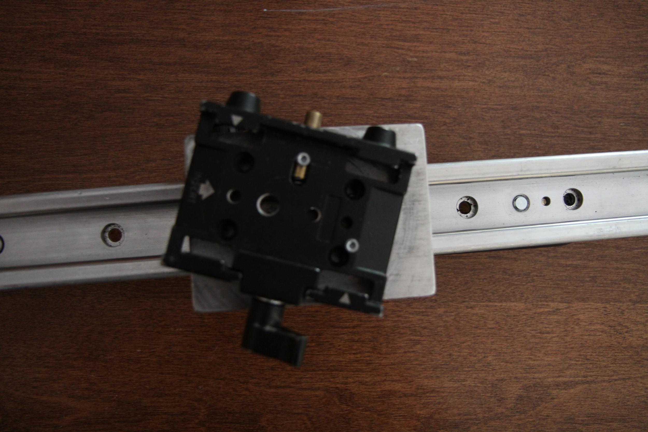

Hi attached is a picture of my DP Slider 720V with a quick release plate on it. To be able to tighten the quick release down all the way to the slider it has to look like this. I'm wondering if there is anything like a Manfrotto 438 Compact Leveler Head that can go under it so that one it is even with the slider's plate and two that I can lock the quick release in position so that it doesn't turn on me when I'm panning with the tripod head.
How do you mount your camera to the DP slider?
I also don't know what size the screw is that is on the DP SLider but it fits the smaller hole of the 351 quick release plate.

I have the same adapter on a similar slider. If your problem is the same as mine was when you tighten the adapter to the stage you cannot turn the lever because it is pressed onto the stage stopping it from turning. If this is the problem, what I did was put a shim under the adapter lifting it just high enough to allow the lever to operate.
Mine works fine now.
