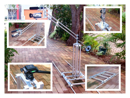

Hi Andrew
Something that really works well for me is the top portion of one of these garden gazebos.. My old one was 3 m x 3m and has a whole bunch of tubes that are 16mm diameter and the dolly still clears normal ground. The great thing about using an old gazebo top is that the sections break down into 20 bits of shorter pipe and each has a tapered end and a little spring clip..it means that you can easily carry/store your rails and it gives you around 6 m of dual track.
My dolly frame is just simple 1"square aluminium tubing across the wheel angles and then I have two threaded rods to keep it square....tripod cups in the corner keep things in place and it's super light to carry..I also have a tower (ally tube) and a crane if I need it....I found a plywood or MDF top made it a bit heavy!!
Chris
