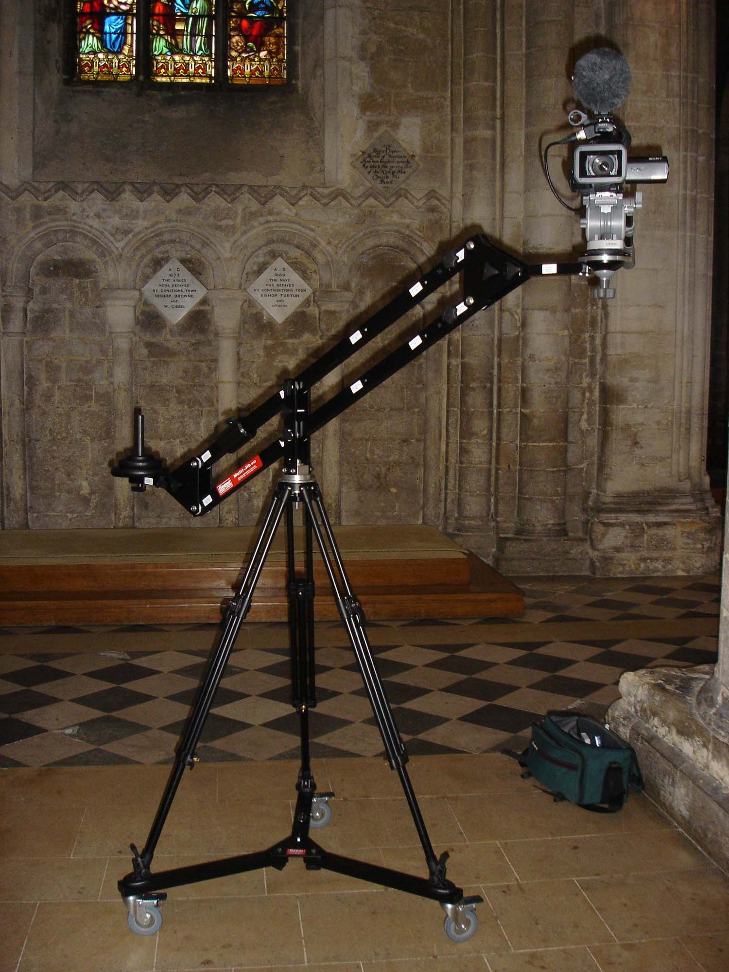

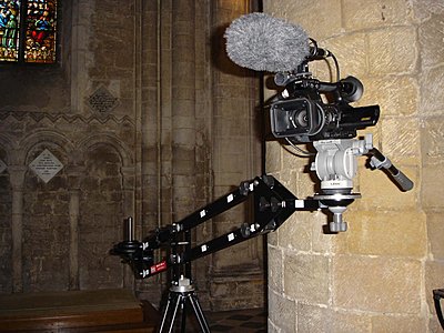

Hague K12 Multijib - Brief Update
I posted on another thread a few weeks ago that we had just acquired one of these and promised to let you all know how we find it. Well, the day draws near (this weekend) when it will be used in action as we have been asked to video an important service in Ely Cathedral. In the end we decided for this "first go" to keep things as simple as possible and just go for the Jib configured in a short length (approx. 1/3 of it's max.) That way, we'll then not need the complication of using remote LANC control/motorised head/LCD screen etc. etc.
We set-up the Jib in some spare time in advance and are really please we did as we had to sort out a couple of things.
Initially, we had problems getting the 100mm to 75mm downconversion ring adapter fitting right at the camera mounting end. My mates larger Libec head (TH50) fits in here but we don't like the design of this conversion ring much and we would have preferred something that maybe had a lip on it and seated more securely rather than just relying on the chamferred bowl sides to "wedge it in". The supplied ring seems something of an afterthought and not as cleverly designed and engineered as the rest of the Jib ...that said they did not charge us for it!
Whilst we're on design, we're still wondering if the wheels on the Dolly are large enough - maybe one day we'll try and fit much larger ones. My mate was keen to do this straight away but I persuaded him that we should spend some time using it then make the mods we want.
So we got it all assembled in the Cathedral and then we tried a few practice shots....very nice!!!! Handles beautifully, very stable, and VERY smooth and certainly looks very impressive! Much admired by all the people who came up and studied it as we got it ready with Warren's V1 on the end! The Libec head on it is a bit stiffer than we would like but that's for another thread I suspect.
Link here: http://www.dvinfo.net/conf/showthrea...971#post784971
During this dry run another minor irritation occurred in that we were getting squeaking noises from one of the Jibs pivot points near the camera head when we moved the Jib angle (now that would n't sound too good in the middle of some crucial videoing!!!) Anyway, 5 minutes later with slightly slackened off bolts and lubricating these points with funiture polish (i.e. silicon) borrowed from the Cathedral Shop lady and that was all cured! Glad we did not have to do all that in a rush on the big day - it only goes to show preparation is always key!
So now we're ready! (as we can be.) My mate will use the Jib and will be on one side of the Ely's famous Octagon and I'll be on the other side with (just a normal!) Tripod (for PD150) and Manfrotto Fig Rig (for Sony HC1.) This I'll use for walking around the Cathedral to get crowd shots at some point as we have been specifically asked to do this by John Inge (the outgoing Bishop of Huntingdon and the future Bishop of Worcester.....who knows what else...this is about as near as I ever get to name dropping!...and I'm not even remotely religious!) Anyway, he's been a very popular guy at Ely and they are expecting a very big crowd!!!
I'll post again after the big event. Meanwhile, here are 2 quick pictures of the beast in it's new habitat!
