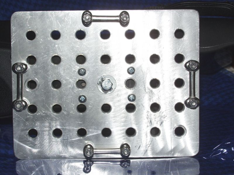

When I drilled the holes for the M4 screws I centered them around one of the cheese plate holes, so I could do this very thing.
Great minds you know!
Bill
Bill,
That's good, as the actual contact area or engagement area of these screws is very small indeed, maybe .005 to .008. Not really meant to hold much of a load.

Hey, I can post images and I do belong to AARP! (Yet!) :-)
So here's one more.
It is finilly mounted directly to the cheese plate...
Also you will see the Footman Loops for the saftey straps.
Think it will go anywhere? :-)
Bill

They are M4 .70 screws for anyone else that will try this with the XL2.
I used ones that were 16mm in lenth with a 3/8" thick cheese plate.
Bill
That's exactly the info I wanted. I too tried the 6/32 bolt but it looked suspect because there was lots of play until it hit bottom. I also thought metric was what I needed. Thanks for popping back in here to fill in the details.
Now I'm off to look for thumbscrews of that size.
