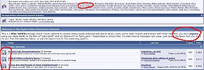

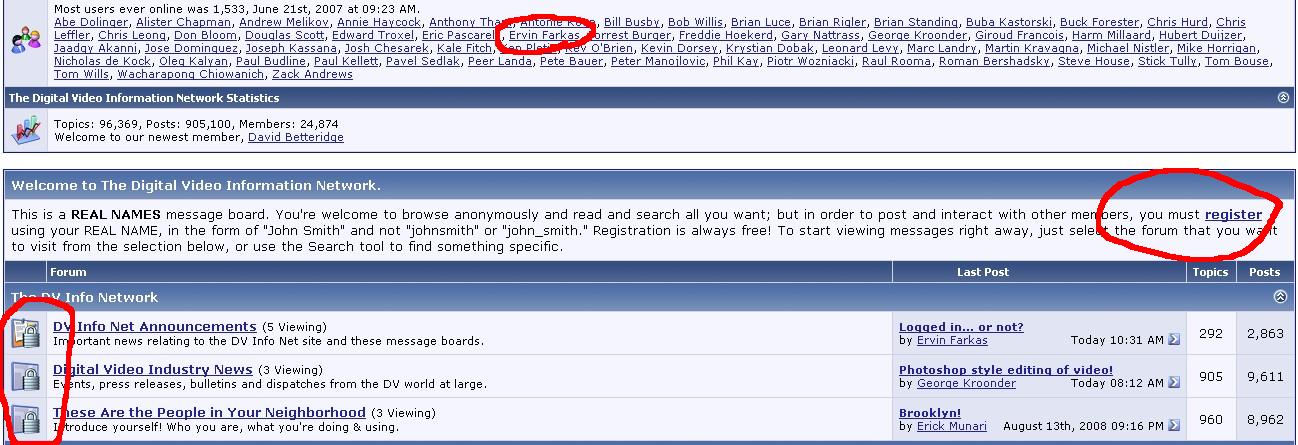

Logged in... or not?
I am logged in, and I can post - despite the fact that the front page asks me to log in and shows the big locks next to each fora.
It's probably just another hiccup due to the move... I just thought I notify you Chris.
This happens if you omit the "www." in www.dvinfo.net/conf. It will show you the front page with "locked" fora/fori/forums (???).
However all the forum links are to www.dvinfo.net/conf. So if you have previously saved your login "cookie" for that it will just work.
Type the "www." and you will get the forum list without locks.
Also Google uses deeplinks without the "www.", so if I follow links from google (which occasionally happens), I'm not logged on (with the saved login).
George/
P.S. I cannot login to the "without www.", as the login form also redirects to the "www" host and logs me in there, then returns me to the non-www, still "logged out".
P.P.S. You must really bookmark or follow a non-www page link. If you just type dvinfo.net/conf in the browsers' address bar, it redirects to www.dvinfo.... Delete the "www." part from the address bar when on the main page to replicate.

I've confirmed this on Mac (Firefox 2/3) and Windows IE7. I think it has to do with the login cookies using the full hostname, so they are not valid on for the url that just uses the domain name.
Not sure if this is configurable or just a board (software) "problem".
If it wasn't for the deep links in Google it's pretty hard to get to the "wrong" url anyway.
