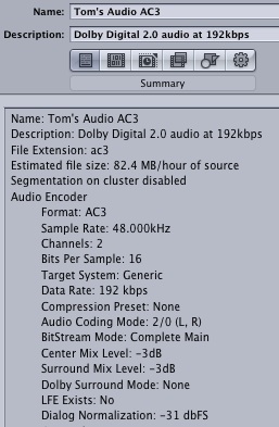

Hi Bob,
I too have had this stupid low audio issue. I corrected this by trial n error, did a few test encodes...and volar..
set normalization in compressor to -31, that did not work for the correct audio level, so then I changed my
"compression" in compressor from Film standard compression to "None", and the audio is now good again
and levels are what they should be when played in DVDSP and in DVD players....
the resulting file size of "None" compared to "Film standard " is exactly the same.
I checked the levels by importing into DVDSP a aiff CD track, played it , and listened to level.
then imported the new ac3 track with the "no compression" setting, and they both are the same level... so all is good now..
I've attached a pic of settings round-up FYI.
Cheers Tom K
Tom K
www.olinevideo.com.au
Tom Klein is offline   Reply With Quote
