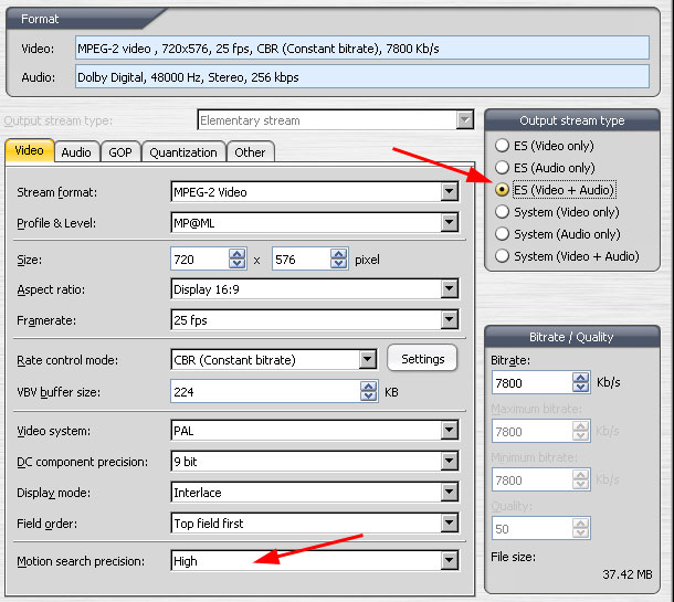

your source can be progressive
but the destination must be upper field first interlaced, it is required by the DVD standard
so, on this screenshot, be sure upper field is selected, near the bottom
http://www.videoproductions.com.au/a...mages/T4-8.jpg
