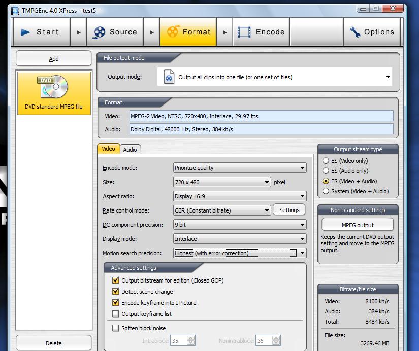

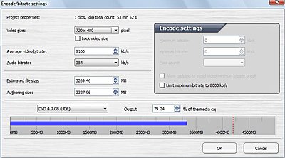

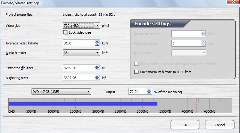

My workflow that I mentioned before was arrived at after weeks of experimentation with different encoding bitrates and 4 different encoders before I got the results that I was happy with. It was very frustrating as I spent much time researching the web for advice.
If you have the time, download the trial version of TMPGEnc - Products: TMPGEnc 4.0 XPress Trial Version Download
It is one of the best programs out there IMO and was the solution I was searching for. The difference in encoder quality is just amazing.
Encode your project at CBR 7000 with PCM audio and then CBR 8100 with AC3 audio. Use motion search set to highest level for best quality. Change setting as needed NTSC/PAL for your intended geographic location. See how this compares to other DVD copies. Also your DVD production house should be able to give you a recommendation for bitrates.
Hope this helps.
