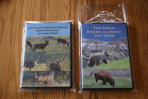

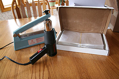

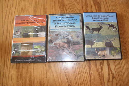

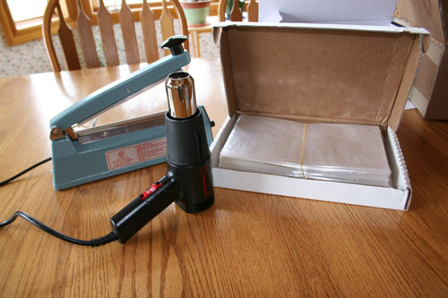

I ordered the 6x11 shrink bag starter kit from this website: http://www.ajminc.com/swspecial.htm. Only being able to order with a credit card via the phone was somewhat inconvenient but with UPS shipping, the package came the next day, which was pretty fast. The kit is basically 500 plastic bags, a heat gun, a sealer, and some spare parts. All you really have to do is put your dvd case into a bag, push it to the bottom, pull down the sealer over the bag near the top of the case, wait a bit for the heat to permeate, and then pull the bag free, thus cutting off the top portion and producing a clean seal. Afterwards, you just hold the heat gun over all the edges and the bag shrinks up all nice-like, just like professional shrinkwrap. But there is a small air hole in the front of the bag, which is necessary but may look bad to some people. Anyway, it took me about 10 minutes to get my technique down and produce a pretty good shrinkwrap appearance. Though I don't know much about shrinkwrap systems, so far, I'd reccomend this kit. The first photo has a DVD case in a sealed bag and one in an un-altered bag, the second photo is the kit itself, and the third photo features the first three DVD's I sealed. I got better each time.
