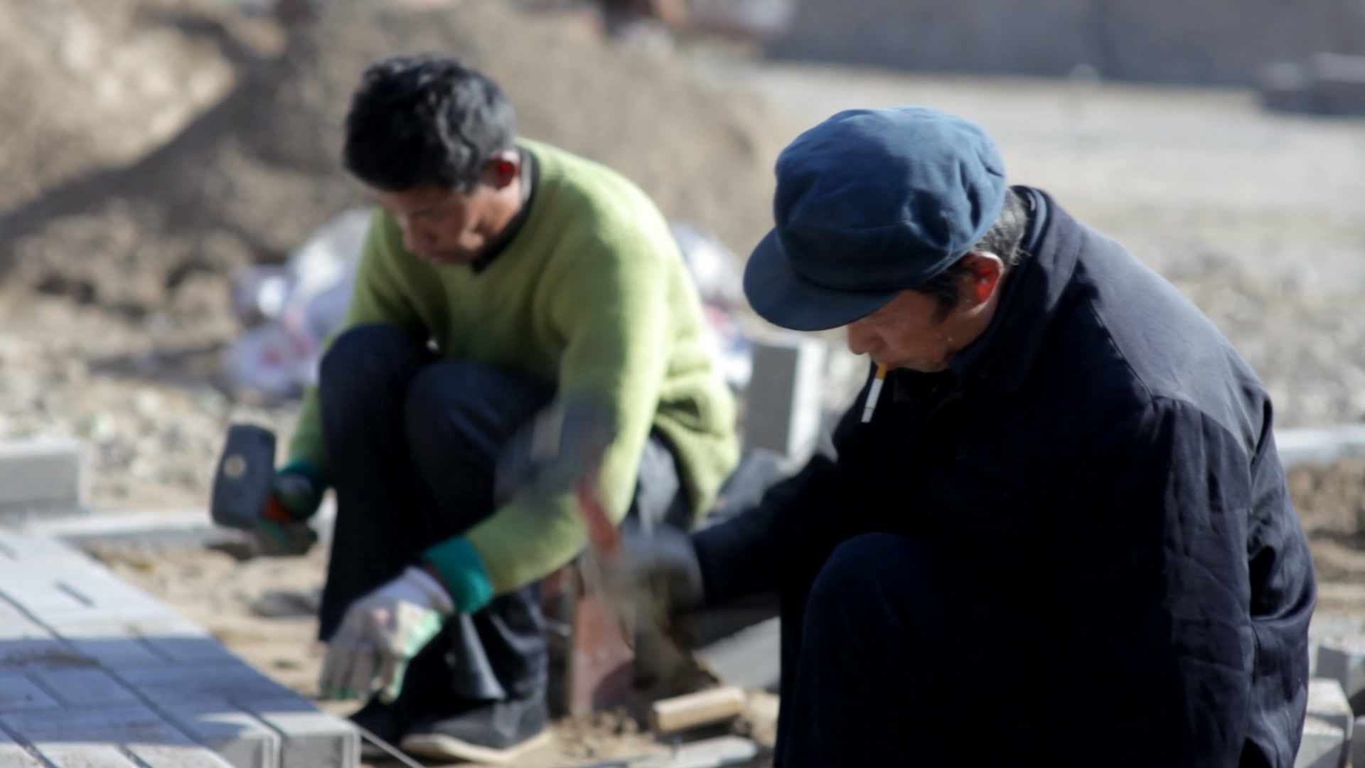

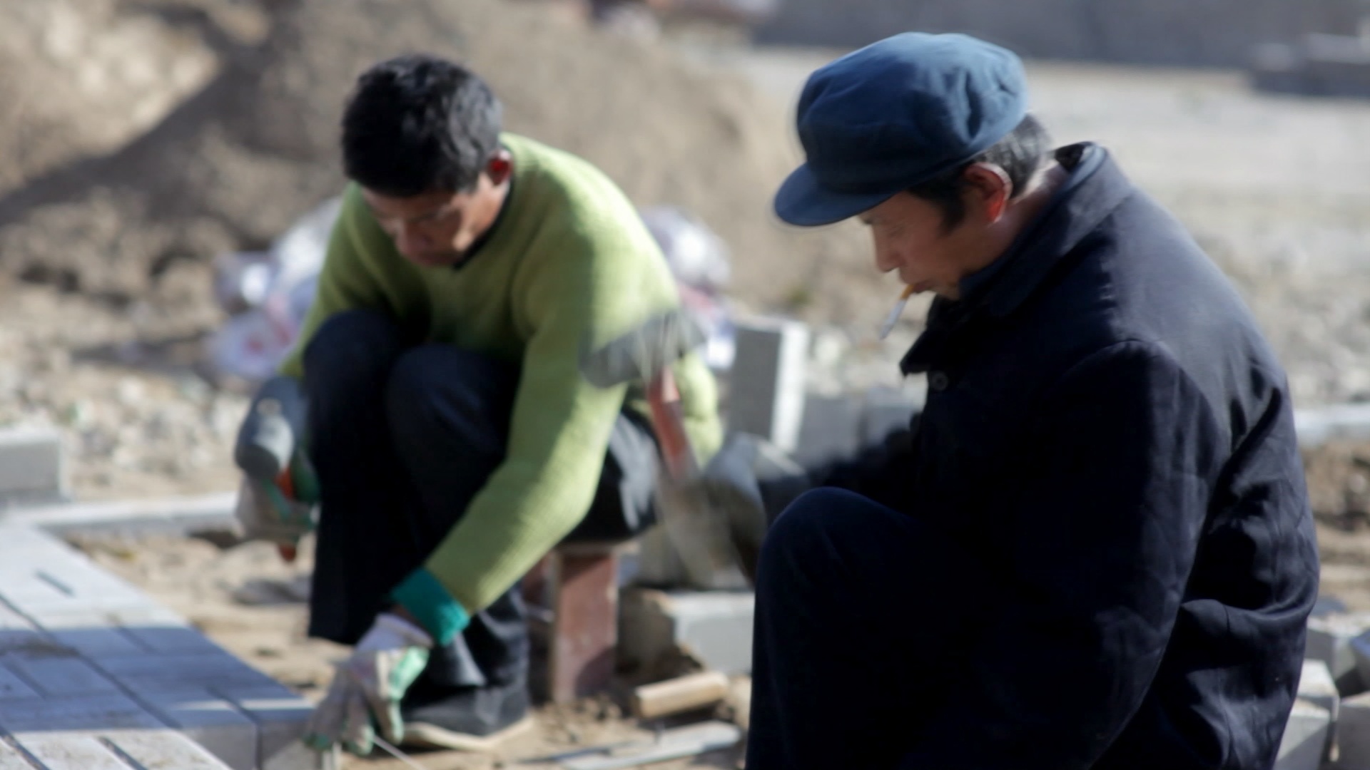

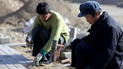

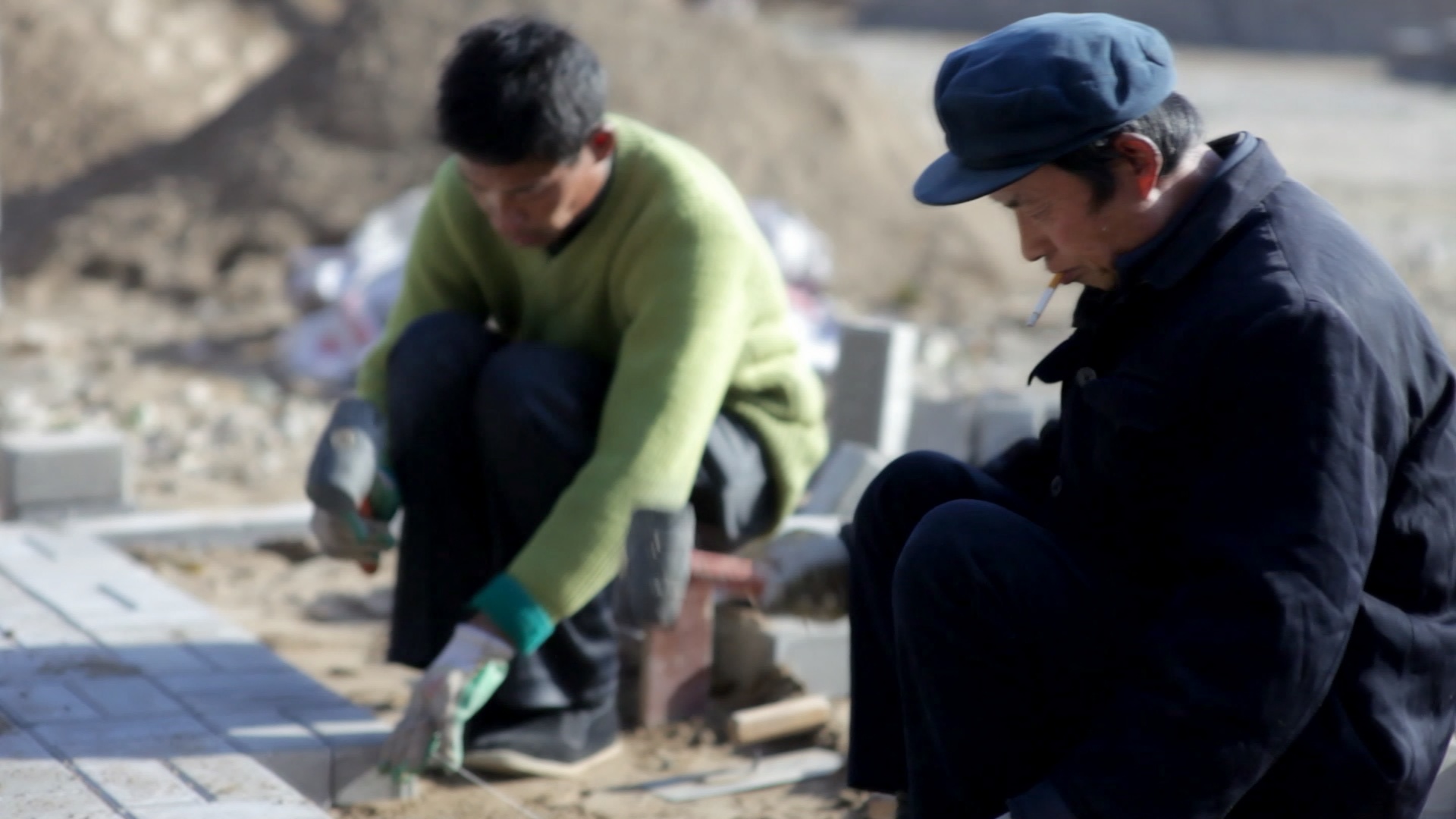

Frame Grabs
Here are frame grabs I did of of two time lines:
"Original" are done at frame 0:16, 1:00, and 2:00 from Chung's original file on a Vegas 60i.
Cineform grabs are from frames 0:12, 1.00 and 2.00 on a Vegas 24p timeline. (Note: I had to take into Photoshop to deinterlace the originals and size the files for upload.
5DmkII with Nikon 85mm at f1.4 in broad daylight test-original16.jpg   5DmkII with Nikon 85mm at f1.4 in broad daylight test-original1sec.jpg
5DmkII with Nikon 85mm at f1.4 in broad daylight test-original2sec.jpg   5DmkII with Nikon 85mm at f1.4 in broad daylight test-cineform12.jpg
5DmkII with Nikon 85mm at f1.4 in broad daylight test-cineform1sec.jpg   5DmkII with Nikon 85mm at f1.4 in broad daylight test-cineform2sec.jpg
