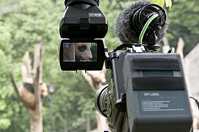

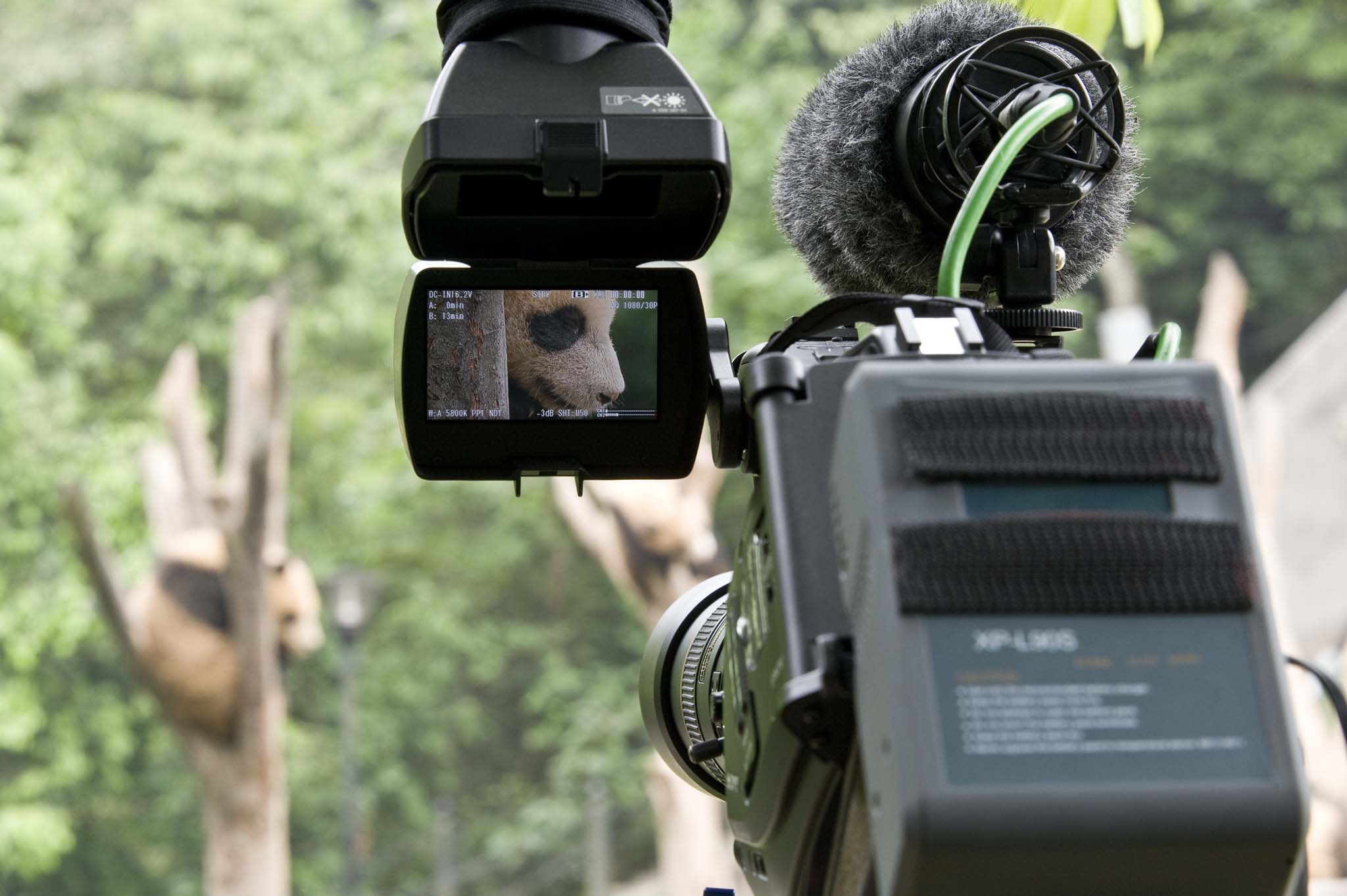

Is currently gracing the front page of the Guardian website. Direct link is here Video: Sichuan pandas bearing up | Environment | guardian.co.uk
Sadly only in low def for now, I hope they put it on Youtube HD soon.
Shot and edited yesterday, it was filmed in 30p mainly on a 5dmkII with a few additional shots from a Sony EX-3 with a MTF services adapter and Nikon long lenses.
Dan
