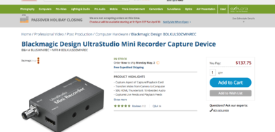

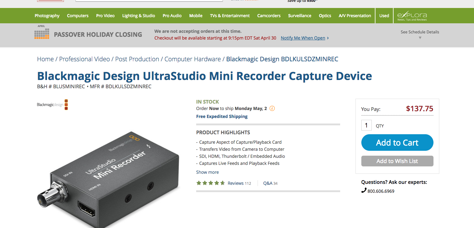

I wanted to follow up on this for anyone else who was in a similar situation, since I hadn't found much other data on it in The Forums. I found two total game changers for me. And I did a good amount of research and wanting to save someone else the time. Or rather there's data, for example discussion about recorders like Atomos Shogun, Ninja, Flame, etc..., but I didn't know any of it and thought connecting the dots might help. And since people usually get those kind of recorders to bypass the camera's internal compression and get the highest quality video already captured, it's a little different then just trying to take a monitored HDMI and/or SDI signal in from an AV feed.
Also for Atomos the first option of capture device where you can see on the device what you're capturing is at $500. That's the Blade series and then the Flame series and despite increasing in price dramatically none of those devices in that series over HDMI AND SDI inputs. It's one or the other. You have to go to the $2000 inferno to have this functionality. I found a Black Magic device for $130 that does it (more on that in a second). So for me it makes more sense to buy something like a Blade if I want to get a badass video signal direct from my camera, and then have the BlackMagic for taking video feeds in from AV Crews at live events of slides, presenter videos, etc...
This may not be new to many people but for me it's a total game changer. Imagine the amount of time it used to take my company at the end of a 2 day conference to take 12 or so hours of footage, since the video and audio, and then look at a B cam video reference shot of the the conference presenters screen and use that as a timing track for when to individually each slide image from a presenters Keynote or Powerpoint presentation. The only options I was ever given to capture this data were WAY more expensive.
1. I looked at the majority of the cheap video game capture devices mileage varies a lot on them with respect to quality, video format and resolution outputted, etc... but the main problem with these more inexpensive options is they don't have screen where you can see what you're recording and monitoring. The thought of not knowing until the end of a conference day recording 6-8 hours of speakers slides if it worked is terrifying. Plus there usually is not a professional input option for SDI on a lot of these so if the house AV crew doesn't want to send you the signal over HDMI (especially if you're 50 feet or 100 feet away) you're potentially shit out of luck.
2. Short of buying one of Atomos video capture devices which don't have HDMI and SDI until you get into the more expensive options the solution actually unexpectedly came from a piece of equipment I had inherited from a job, never used, but had already (that's a first). The Black Magic ULTRASTUDIO Mini Recorder. It's $137, it's tiny and easy to use. It takes SDI or HDMI (not simultaneously) and outputs Thunderboldt. You can download an application for it called Black Magic Media Express for free and monitor what you're capturing right there in a ton of different formats and options. I was delighted. Because having a laptop setup on a small table near my camera setup at a conference (because you stay stationary all day if you're filming the General Sessions as opposed to a promo video of the whole event) is totally doable. Same thing for shooting in a studio. And if you want to go full screen and turn your Macbook you already own into a badass fullscreen large HD field monitor you can purchase a piece of software called Scopebox. There's a rad video by MrCheesy Cam that shows how to do that (although he does it with a Black Magic Intensity device and not the Micro but same principle). And the software does a bunch of other really useful things as well. That was gamechanger number 2 for sure.
Hope this helps folks!
p.s. I have no affiliation financially with Black Magic or Scopebox or any of that. I was just stoked to find out these solutions and wanted to share after what felt like a lot of research.
