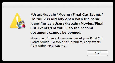

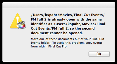

When I start FCPX I get the attached dialog, and when FCPX is running my (migrated) project is not visible. If I quit and then start it again I do not get the dialog and my project is now visible. This is the only project I have going and there is only one "FM Full 2" in my Events folder.
Any suggestions on what is going on here?
