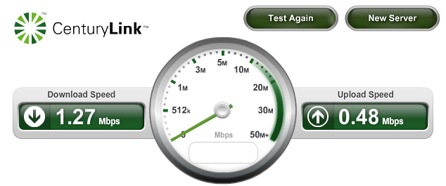

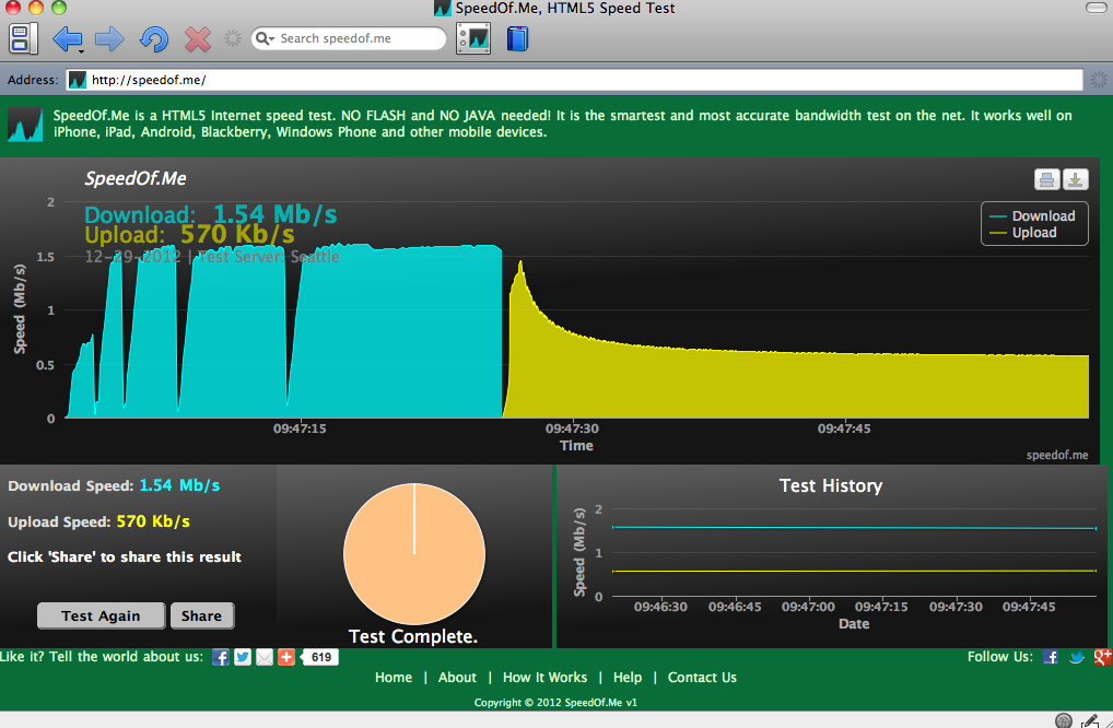

Upload & Download speed tests:
If one is interested in how fast their Internet connection is, there are some computer speed tests available.
Century Link: theirs can be accessed at speedtest.centurylink.net
There were no cookies in connection with this link.
another resource is speedof.me
This site says there are no cookies but Google sends one tracking cookie. Also, Java and Java Script must be enabled.
These were done with DSL via a wireless connection. One can get faster speeds by connecting the computer with a cable directly to the modem. It is also recommended to delete the trash and cookies.
