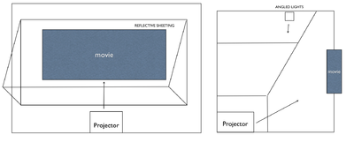

What basically happened is that I believe the setup was never correct in the first place. There is a projector which in essence is just projecting onto the back wall with then the angled plastic sheetings in front of this. It doesn't create any sort of Peppers Ghost effect.
I've done a really rough drawing to show you. Having been today with a smaller projector, I find if I project straight up it seems to work ok and create the PG effect. The issue is that the original projector is massive and I'm unsure if it will create the required throw..It's about 7000 lumens.
What do you think?

Slightly confused by your drawing as it seems to show the projector at an oblique angle to the image which would surely distort it? I can't see why a comparatively low output projector showing the image on a screen in a darkened area shouldn't be sufficient. If the screen is to one side of the 'stage' hidden from the viewer, with a vertical sheet turned at 45 degrees to the viewer, the reflection should be visible.
The wikipedia entry for Peppers ghost is quite useful. Pepper's ghost - Wikipedia, the free encyclopedia the whole thing seems to work in the same way as a teleprompter as far as I can see. I don"t know how big your display is, but maybe a tv could be used instead of a projector if the display is a small representative one.
