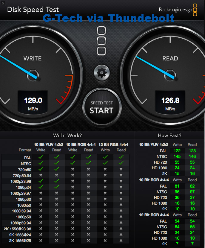

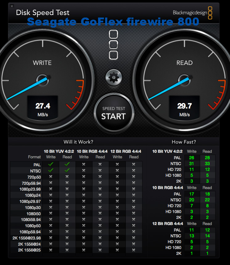

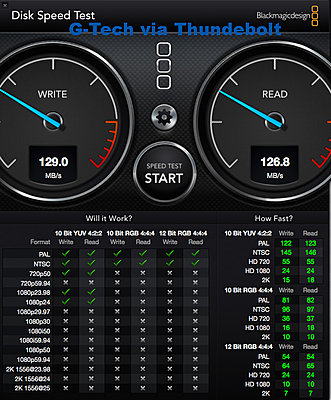

I have the G-Tech and several other pocked drives, the G-Drive is faster than the others as its my only pocket drive that runs at 7200 rpm... speed is the same connected via thunderbolt or USB3.
Careful with some of those little Seagate drives they are really slow.
both are 1tb drives and are about 85% full
External drive Thunderbolt vs USB 3.0-old-track-porta-drive.jpg   External drive Thunderbolt vs USB 3.0-thunderbolt-g-drive.jpg
