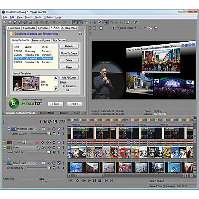

Hey folks. I film a lot of conferences, keynote speeches, panels, etc., and I'm always wondering if there's a software out there to make the redundant portions of the editing faster. For awhile (and before FCPX) I was using Red Giant's Presto. It was pretty buggy but fairly often it could match up a video of a projector's slides, with the actual digital slides I'd get after the show, and also track the speaker as he/she moved across the stage (so that speaker and slides could be on screen at same time).
Anyway, since Red Giant doesn't have Presto supported for FCPX are there any other similar app solutions that have been built? I'm trying to work in the smarter not harder category.
