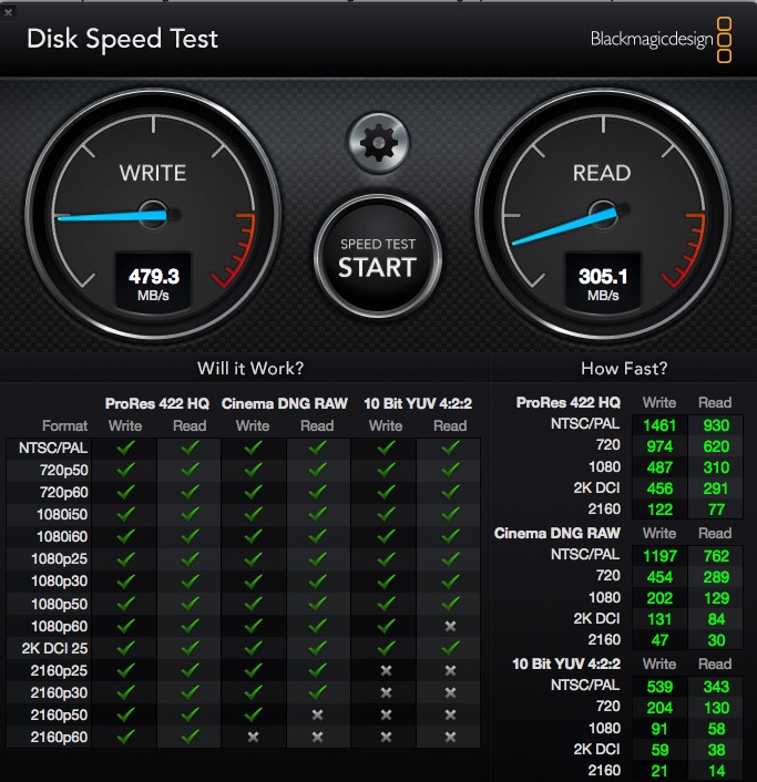

I went down the path of getting a Dock because the monitor compatibility problems go away when it's connected via DP. But before it arrived and while Apple is working on the Sleep/Shutdown problem when connected via USB-C, I found that I can sleep/shutdown and then quickly power off the monitor before it causes trouble. The dock is sitting in the box. I read a post that since it;s a USB-C dock (not Thunderbolt3) it only runs the mini-DP connected 4K monitor at 30Hz. That's a non-starter for me if true. I'll wait for a TB3 dock.
My gut says the MBP is putting something on the wire the DELL U3818DW wasn't expecting and things go down the tubes. Turning power off on the monitor prevents it from responding or whatever and waking up everything. But I'm guessing. The TB2 G-TECH G-Speed Studio RAID handles it fine connected only by a TB2 to TB3 adapter from apple. They are a good buy if you can find them in stock.
I found that TB2 connected RAID was as fast as my internal drives on the cheesegrater. The silent running of SSDs is enticing. When I don't need the RAID, I power it down.

This is what I'm seeing on the MBP with the G-Speed Studio.
