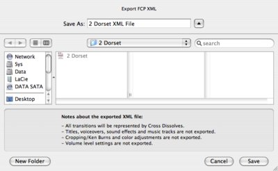

There are some limits with the export feature in iMovie 08. See the attached screen shot.
iMovie 08 can be used to rough cut for FCP-imovie-08-xml-export.tiff
Sean Paterson is offline   Reply With Quote
I can live with that!
