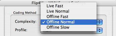

I use Compressor 3 with Flip4Mac Studio Pro HD components. I suppose you could use any compressor software that can access the codec components, including Quicktime Pro, Sorenson Squeeze or Cleaner. You can download the WMV Compressor app for Windows from the Microsoft website. It is free, but doesn't seem to want to play with quicktime files, even if they are Cineform codec.
When it comes to compression, the term "good" can be very subjective. Do you want low bit rates/file size or high visual quality and frame rates, or maybe meet somewhere in the middle.
I think the key to "good" WMV compression is understanding what all the different options in the WMV codec actually do. Unfortunately, I'm still trying to understand a lot of Microsoft's terminology. For example, the complexity option can be set to "Live Fast, Live Normal, Offline Slow, Offline Normal, or Offline Fast." Does this mean the complexity of my source material, or is this some way of prioritizing bit allocation? I have no idea.
There's also the Smoother/Sharper slider. Does this mean my frame rate will drop if I increase it to the Sharper side? Or maybe this is edge enhancement/sharpness? These terms are very confusing.
I've experimented with both 2-pass VBR and 1-pass CBR and frankly there doesn't seem to be much of a savings in file size or an improvement in bandwidth allocation/image quality with 2-pass VBR (and the compression time doubles.)

I found a tiny bit of info on the Microsoft site and it explains Smoother/Sharper, but there is no mention of the 'complexity' option.
http://www.microsoft.com/windows/win...anEncodingMode
Ken Stone's site has an article with a mention of 'complexity' determining how long the encoder spends encoding the frame. "Live" is low quality but quick, "Offline" is higher quality but slow.
http://www.kenstone.net/fcp_homepage...4mac_gary.html
