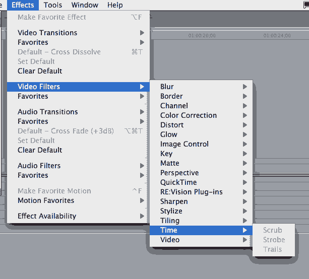

See this attachment. I can't believe you don't have it if you have 5.1.4. I do too, and I haven't installed any external plugins.

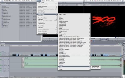

I would like to have that "trails" filter too - but I don't - see below:
I have FCP v5.1.4. What's going on here, anyone?
( I also notice I haven't got some others shown above too: like the "Tiling" group? )

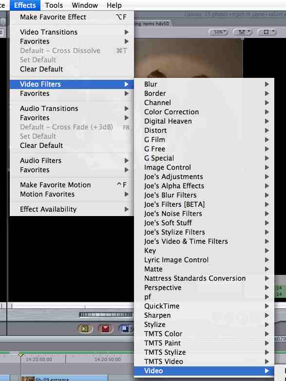

Make sure you have "All" filters available; see attached.
I do. Curiouser and curiouser.
