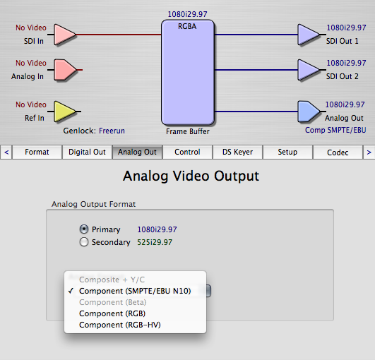

Ok, how about component vs. composite out?

Phil,
Here's the settings (NTSC version) that you should have. Your primary settings should match whatever your timeline settings are.
If that still doesn't work then the make sure: A) The hydra cable coming from the Kona card is securely fastened; B) The RGB monitor is properly set to look for inputs from the Kona; C) Hook up the monitor to something other than the Kona to verify the monitor is working properly.
If all else fails contact AJA tomorrow.

thanks but it looks like it is all set up fine. There must be something wrong with the card
