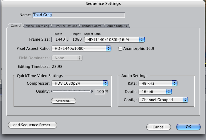

What are the appropriate sequence settings in FCP6 for footage shot on a Canon XH A1 at 1080p24 and captured as HDV 1080p24?

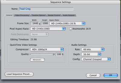

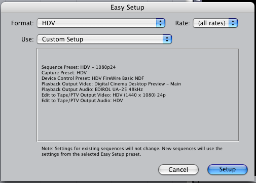

My sequence settings and easy setup are shown in the attached screen captures. Every time I export the sequence through QT conversion the result is a 4:3 ratio image, unless I enter a custom size like 1440x810 in the QT size menu. Unless i really was asleep during all of high school math class 1440x1080 is not a 16:9 (widescreen) ratio.
The image looks fine in the viewer and canvas incidentally, the aspect is what it should be.
Are my sequence settings the problem?
I'm confused.
As always your insight and knowledge are always appreciated.
Rich.

Your sequence settings are fine. That's why the viewer and canvas windows look correct.
The bit you slept through in high school was the class on pixel aspect ratio (or maybe that's not covered in high school maths). Pixel Aspect ratio for HDV is 1.333:1.
1.333*1440 = 1920 (or near as makes no difference.)
You can export the Quicktime movie as 1440 x 1080 and then adjust the aspect ratio of the finished film in Quicktime Pro under Movie Properties>Video Track>Visual Settings>Scaled Size to 1920 x 1080.
However if you export using Quicktime Movie rather than Quicktime Conversion using the HDV 1080i setting it should preserve the proper aspect ratio.
