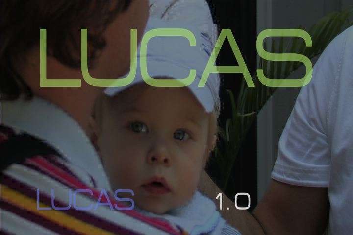

OK, so I think I figured out most of my issues except one. For some reason when I take save a frame as a still image I get this weird interlacing (attached). I've tried saving in multiple formats but can't seem to fix it. Anyone have any idea what I'm doing wrong? Thanks in advance for your help

This is interlaced footage Paul. When I shoot on my XL2, every time I use either reverse telecine in Cinema Tools or JES de-interlacer to get rid of this interlace junk. Search the forum for De-Interlacing and you'll get tons of threads.
If all you want to do is take a screenshot just hit Control-Shift-3.
No interlacing, I promise. :P

Thanks Christopher. Funny you mention reverse telecine. I am editing a new project in which my videographer shot with the advanced pulldown option (XL2). I ran the reverse telecine process and added the clips to a 23.98 timeline. I like it much better. It just seems like it's much "cleaner" footage to work with. It's an extra step but seems well worth it. Guess it's a lesson learned for a newbe like me.
