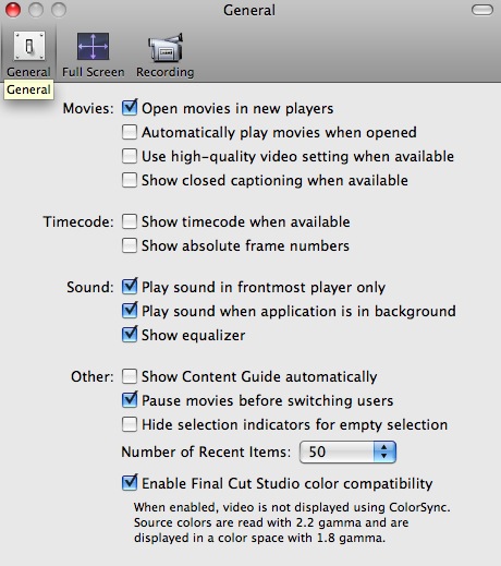

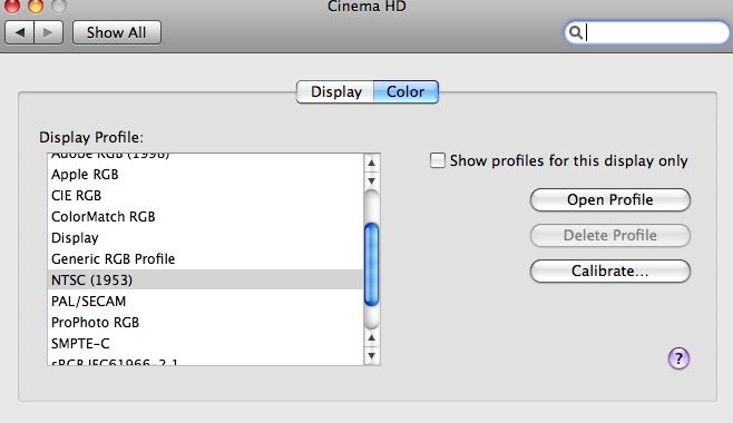

Actually, that's not the case. When Final Cut Pro is installed you then have the option to have Quicktime use the same gamma/color space as Final Cut Pro, which by default it does not. That's why when viewing in in native Quicktime things look muted and shallow. See the enclosed menu grab, check the radio box to enable FCS color-match and QT will look exactly the same as FCP.
Additionally, if you want your LCD monitor to closely replicate the same color space that a TV's use, goto your color preferences and set the NTSC 1953 setting. That will give your monitor the correct gamma setting to replicate how a TV produces it's color. This assumes you're either using a Apple Cinema Display or one of the more recent Sony, Samsung or LG monitors which by default already have the correct balance of brightness and contrast setup. Older monitors you may need to tweak manually to get the best use of the NTSC color space.

You are my hero of the day! I am, in fact, using an apple cinema display and my external monitor is a brand new Samsung LCD. I just did some quick tests based on your comments and was able to fix all of my problems with color/luma variations. I set my color specs to NTSC 1953 and boom, I was seeing exactly what I was having a problem with and was able to correct the issues, through color correction, for proper display on all (most) standard televisions/monitors.
