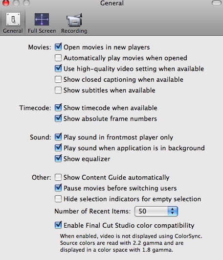

The NTSC 1953 preset in the Color Profiles will closely replicate the color-space of an NTSC signal on your ACD; no computer monitor regardless how it's being fed can accurately replicate how a tube-type TV displays it's information, which is why if your content is destined for either broadcast or DVD it's best to have a tube-type monitor as your main *external* monitor. (see the post referenced below)
http://dvinfo.net/conf/showthread.ph...917#post829917
There are two things to consider about getting a WYSIWYG output from FCP to DVD:
If your ACD is old - more than 3 years of constant service - then it will not properly display any colors correctly. Like everything else, the color accuracy of LCD displays degrade slowly over time to the point that they will eventually have a fixed and un-correctable color shift, most going either blue-ish green or yellow-ish in tint. There's only one way to fix it and that's with a fresh monitor, either ACD, Dell (same monitor components for far less in cost) or the Sony pro-models.
The other thing to keep in mind is to use the "match FCP output" if you view your final content in the native Quicktime player outside FCP; see screenshot for the option I'm referring to.
If you use either a KONA or BlackMagic card to view your content externally to either a standard TV set (with component input) or a broadcast monitor (that's been properly calibrated) then using the NTSC 1953 preset for your ACD or main LCD monitor then what you see in the viewer/canvas will very closely match what you see on the external.
One last thing: Monitor calibrators such as Spyder are only for printed graphics, so that your monitor can closely match what your in-house printer is outputting; they are completely useless for film/video editing. That's why the large post-houses and production facilities will always watch their final content on various TV's and monitors, to see how their color-correction schemes work in real-world output. There's no way to perfectly color-match your final video to every monitor the end user will use, because you can't control what it is or even if *their* TV-set or monitor is itself properly setup.
