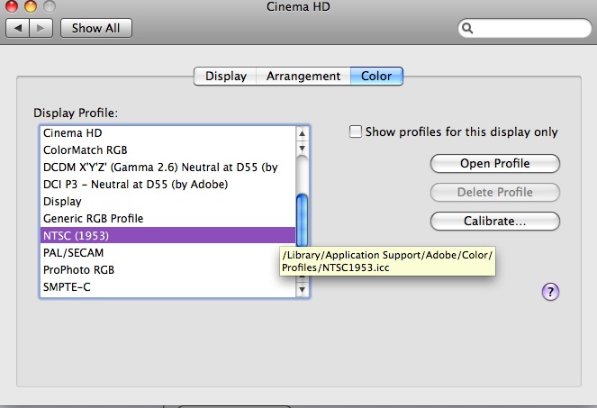

Jason,
If you're editing on FCP then you'll have a very important monitor preset that will give you what you want:
In System Preferences Monitor Color tab, select the "NTSC 1953" preset; this will give you the closest monitor response when editing.

If you have FCP 5 or 6 on your machine then you should be seeing that as an option.

In your display preferences make sure the "Show profiles for this display only" is unchecked.
