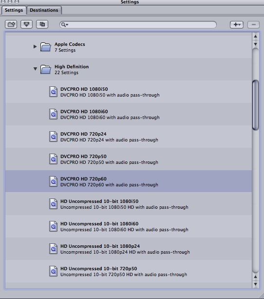

The best thing to do is to export as a reference movie, then use Compressor's built-in DVCPRO-HD encoder to create the conversion.

Robert,
That worked perfectly for me and got me out of a real jam. Now I can finish the DVD, send it to the client and the replicator and get on with my life instead of spending days waiting for failed render test after failed render test.
Thank you!
