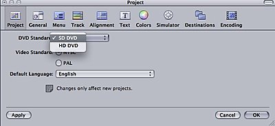

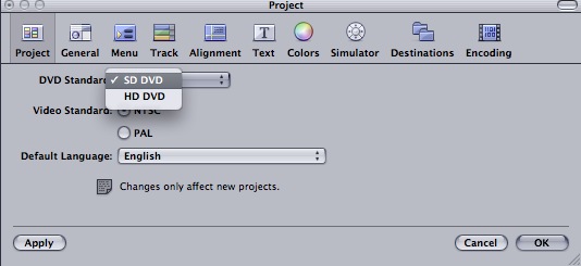

Check your default project settings; chances are it's set to HD-DVD rather than SD-DVD and you don't know it. Go into Preferences to verify.

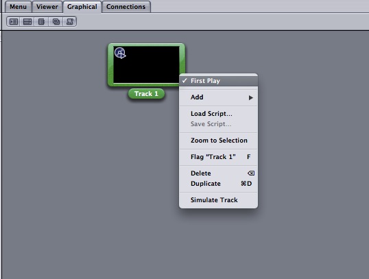

Also, if you want to make a quick test burn of whatever you're testing there's a very fast and simple way to do it:
Import whatever assets you're working with; go into the "Graphical" veiw option and drag the M2V/AC3 (or whatever combination files you have) directly to a single track. Right-click (control click) on that track icon and select "first play"; make sure this track lives alone - no other tracks or menus should exist - then do a direct burn to DVD. When you insert the disc it will auto-play that track and simply stop at the end (unless you go into it's properties and make it loop on itself by making the end-jump the start of the track). Fast and easy.
Thanks, that was it. I assumed that it was smart enough to guess that when you drop SD track then you probably want SD DVD. One question more: My src is 16:9, which kind of display mode should I use?
