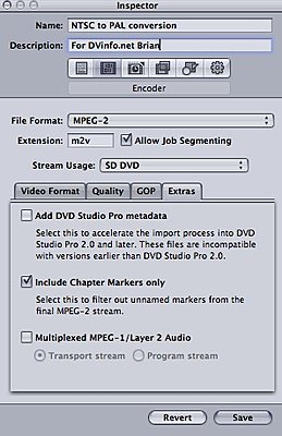

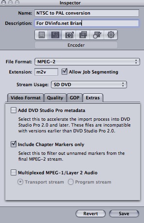

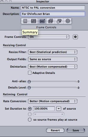

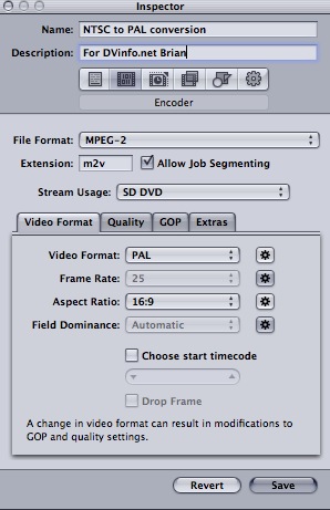

Brian,
Here's your magic bullet. With respect to "Frame Controls" you could use the "Best" setting but that will turn on Compressors Optical Flow filtering and encoding times will increase exponentially and might be painful to wait for depending on the length of your sequences.
Remember that once you make your encoded DVD's for PAL that unless you have a DVD player that supports the multiplexed playback options (NTSC and PAL) you won't be able to view the content except on your Mac DVD player.
definitive HDV NTSC to PAL workflow-picture-1.jpg   definitive HDV NTSC to PAL workflow-picture-2.jpg
definitive HDV NTSC to PAL workflow-picture-3.jpg   definitive HDV NTSC to PAL workflow-picture-4.jpg

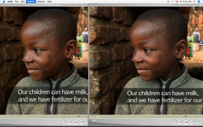

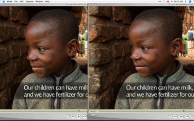

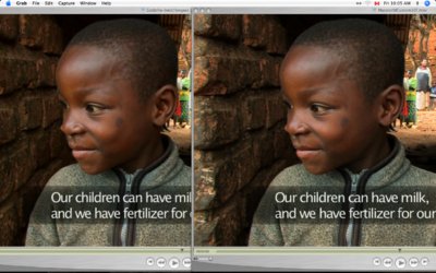

Thanks much for that! I did so much experimenting that all the quicktime players on my screen made my head spin (more than usual...). Your settings are, i believe, the clear winner. i am posting a few screen shot comparisons: your settings on left vs 1.macworld settings 2. vs. dv pal anamorphic stock compressor settings 3. your settings without pal convert vs. best qual 90 min.
the differences are very subtle in the 90 min best qual comparison, but i see the background as richer and titles slightly clearer. and the other PAL SD converts would have to be transcoded AGAIN for DVD, i believe... but head still spinning slightly...
still wondering if Natress would do better?
and best Frame rate for convert to PAL? i think, for me, 24f looks jerky on pans and zooms in the first place, soooo 60 or 30...hmmm...

Ever since Compressor 3 was released it is the absolute best encoder for the Mac, a close second is Episode Pro however to get it's full functionality you have to spend about $900 - 3/4th's the cost of FCS2.
Compressor now has a plug-in available (again, very pricey but the results are stunning) from: http://www.omni-cinemacraft.com/prod...ncodermp.shtml . Right now that would be the best software-only encoder that could come close to a hardware encode for the Mac.
Nattress simply doesn't have the same amount of controls that C3 does nor does it's quality of output match the ultra-clean results you get from C3.
