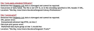

Not sure if this is relevant but I have found these error files on my internal HD (via disk warrior) - I've attached a snapshot of the report:
I know that the bottom file (version p.list) was stored under library/prefs/final cut pro user data/FCP rescue 5 - might it be this program conflicting with FCP and causing crashes? Anyone experienced conflicts with this program?
I've posted this on a mac 'genius' board to see if I can fix anything before inevitably taking the machine in.

".plist" files are preference files and can sometimes become corrupted beyond repair. This is one reason why I strongly suggest using Onyx on a regular basis to help avoid this issue.
You can delete the corrupted .plist files (if you know how to find them) and let the OS or app rebuild them. But as indicated before you should take your rig to Apple for servicing.

I've had a crash course in Mac housekeeping this weekend Robert so something good has come out of all this. I'll pick up Onyx too whilst I'm at it. I've stuck these two plists (scheduler and version) into the trash.
I've found a similar issue on a mac site (apple board) - recommended updating the mac OSX combo 10.4.11 then if necessary going down the archive and install route (one step behind a full osx reinstall I guess?). There's also a recommended prog called Applejack.

Indeed Robert. I learned the hard way this weekend, although fortunately now back on track - a smooth running system it seems, fingers crossed - looks like Disk Warrior (which has been fantastic btw) did indeed route out rogue files (plists - version and scheduler).
