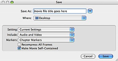

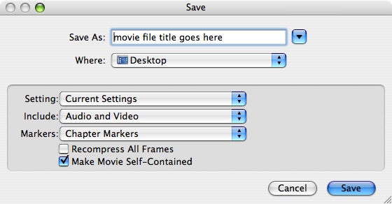

how do i get from fce to idvd
A recommended method would be to export your completed timeline from FCE as a Quicktime Movie. Make sure to select the appropriate options (full quality?) to conform to the desired settings for your final DVD in iDVD.
Don't bother with the options exporting via the Quicktime Conversion option if it is offered because you don't want to create an end file with additional compression applied. iDVD expects a full quality file and will apply its own compression during the DVD rendering process. Just use the Quicktime Movie export option which is typically the first one listed in the export window.
When the resulting options window comes up, put in a file name, designate a location to export to, choose the default "Current Settings" tab unless your needs require otherwise - which will export a file in the format of your FCE project settings.
You can opt to to select "Make Movie Self Contained" or don't. Each option has its pros and cons. Checking this arguably provides a more stable file for your DVD authoring, but results in a large file (dv at ntsc settings averages close to 13 GB per content hour). (see attached image) Un-checking the self-contained option provides you with a reference file export that references your project timeline. A lot of folks prefer to use this method because it is a much smaller file, quickly exported and saves workspace on your drive.
Your noted workflow indicated that you had been moving your movie files from FCE to iMovie and then to iDVD. You didn't indicate why you did this. You also noted that it gave your inferior image quality. I am suspecting that your chosen export option may have involved exporting via some alternate compression default (perhaps an inferior or highly compressed codec) that would pixelate or lose definition once opened up into DV format in iMovie....just a guess.
Some folks have continued to use iMovie in order to set up chapter markers that would be properly recognized in iDVD. If this is the case with you, then I am assuming that you are using an earlier version of iMovie because the newer version no longer offers very suitable integration with iDVD. However, it is easy to set up chapter markers in FCE (or FCP) that will be recognized in iDVD.
Just select your timeline in FCE, and place your playback head wherever in the timeline you wish to add a chapter (starting with the beginning and on to each location you want a chapter to begin). Once there, press 'M' to drop a marker there. Press 'M' again to bring up the Marker Edit pane so you can designate the intention of that marker. You will get a window (see attached image) that allows you to make a title for that marker, and select the tab that designates it as a chapter marker.
Now, when you export your Quicktime Movie, make sure you include the "Chapter Markers" option in the Markers tab (of your export options). Export your Quicktime Movie.
Open up iDVD and select your desired theme. Drop your exported Quicktime Movie into the iDVD interface and it will automatically present your title selection as well as the Scene Selection option that conforms to your intended chapters. Customized the remainder of your iDVD projects as desired.
(important note: if you chose NOT to export your QT Movie as a self-contained file, then the resulting reference file will be linked to your FCE project. Any changes to the location or contents of this FCE project will require the embedded file in the iDVD project to be updated because the reference file is only acting as something like an alias (or a shortcut in Windowspeak) for iDVD to know where its getting its contents from)

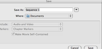

Johnathon - my Final Cut Express does not have the "settings" option when I try to export as Quicktime.....
Am I doing something wrong?

Old September 11th, 2008, 05:02 AM   #8
Location: Colorado USA
Posts: 40
here it is
quality FCE/imovie/idvd   / fc  ??-screen-capture.tiff
Janis Williams is offline   Reply With Quote

Old September 12th, 2008, 03:41 AM   #13
Posts: 40
Nope sorry - that is not the problem.....
I just do not have settings - look at the screen capture...

Old September 20th, 2008, 01:03 AM   #15
Posts: 40
no
seems it was removed from FCE but left in the documentation....
the help file for this is incorrect and no such options and selection exist in FCE
Why does it feel like Apple are turning into Windoze???
So far I keep having problems that turn out to be their error and a lack of interest from them to rectify.....
