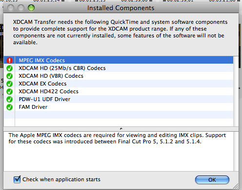

I started the xdcam transfer application outside of Final Cut and got the attached screen, warning that the MPEG IMX Codecs are need by xdcam transfer and evidently are missing. Now, FCP has had a full reinstall during all this and so have the xdcam utilities.
Does anyone know:
How to check if these are installed somewhere?
If not, do I need to install them?
Where to get and install them?
If this actually might be the source of these crashing problems?
I hope.
