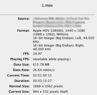

After using Log and Transfer to import the footage, here are the movie specs (viewed in Quicktime's Movie Inspector):
Format: Apple HDV 1080i60, 1440 x 1080
(1888 x 1062), Millions
16-bit Integer (Big Endian), Left, 48.000 kHz
16-bit Integer (Big Endian), Right, 48.000 kHz
FPS: 29.97
Data Rate: 26.64 mbits / s
Normal Size: 1888 x 1062

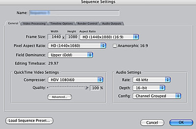

Now, when I drop it into FCP and it auto-adjusts the sequence, here are the settings that FCP gives me:
Frame Size: 1440 x 1080
Aspect Ratio: HD (1440x1080) (16:9)
Pixel Aspect Ratio: HD (1440x1080) [Anamorphic 16:9 UNCHECKED]
Field Dominance: Upper (Odd)
Editing Timebase: 29.97
Quicktime Video Settings
Compressor: HDV 1080i60
Quality 100%
Audio 48kHz 16-bit Channel Grouped.
