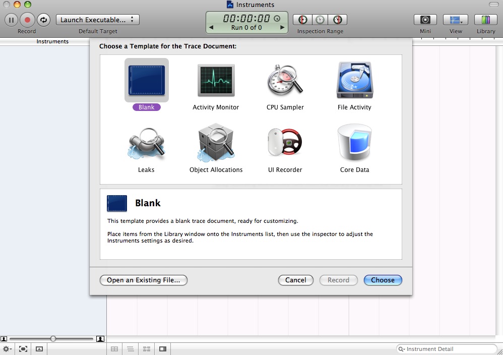

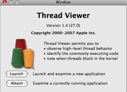

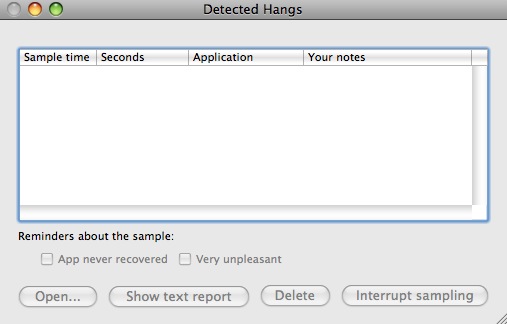

Hi Don,
It would be impossible to tell without physically being at the affected system first-hand but there is a relatively quick and easy way to test the hardware theory:
Built into the Xcode bundle of programs available from the Mac OSX install disk are 3 utilities that can help diagnose memory/system related hangs or problems:
1. Spin Control
2. Instruments and;
3. Thread Viewer
When loaded they can be found in DEVELOPER/APPLICATIONS/UTILITIES folder.
Read the instructions for each app and you can self-diagnose which application is causing the hangs/failures/memory leaks etc and send this info to either Apple, Adobe or both. These apps will clearly define whether or not the issue IS hardware or software - or both.
If it is hardware/SuperDrive related do this:
Goto "ifixit.com" and download the guide on how to replace the SuperDrive yourself. Pick up another SuperDrive from OWC or another supplier of MacBook Pro-compatible DVD burners ( Find the latest Performance Upgrades, Firewire and USB Hard Drives, SATA, Memory, Laptop Battery, and more at OWC ) and try the newer burner. You might also look at your RAM and see if there any memory hangs or program halts causing the issue.
