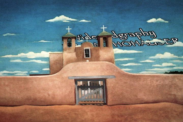

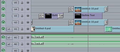

The funny thing is that right after I wrote that suggestion I ended up doing a variant of what I described on a client's project. The scene called for a title to rise up from behind a building yet be in front of the sky. I duplicated the building footage on tracks 1 and 3 and placed the title graphic on track two. After a little tweaking with the key settings on track 3, it worked out great.

Sure that'll work but look at a screen grab and the result of what I did.
Chroma Key 'Before and After' transition.-fcp-screen.jpg   Chroma Key 'Before and After' transition.-copeland.jpg
