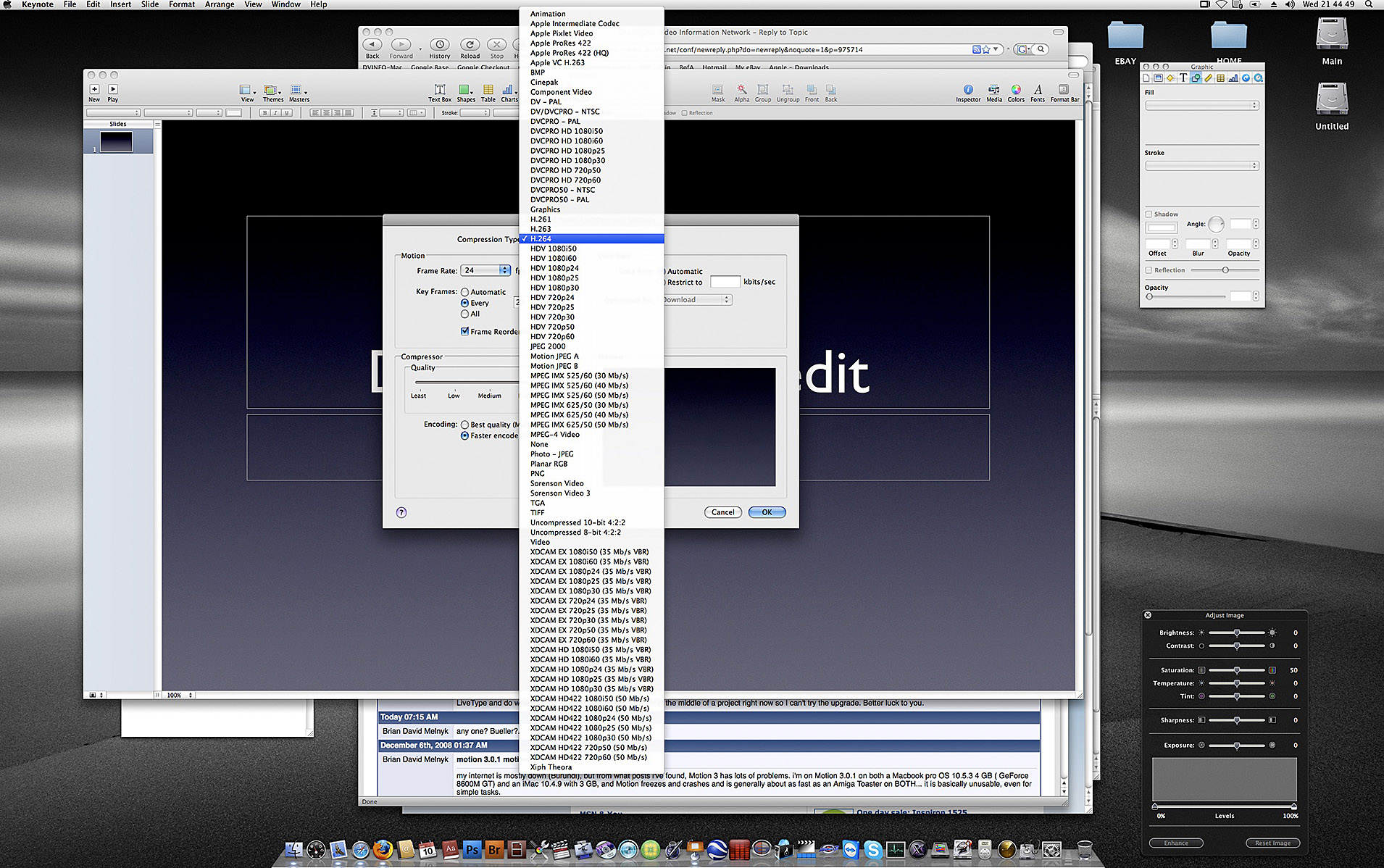

The cheap-and-dirty option is to use Keynote. I know it sounds crazy but I've used Keynote on several productions to create motion graphics with gorgeous text fly-in's fades - you name it. (If you do a search on this forum you'll see a post I made about how to use it). Surprisingly, you can actually output a finished Keynote project in any video codec you have loaded on a FCP system, up to and including uncompressed formats! (see attached screenshot)
