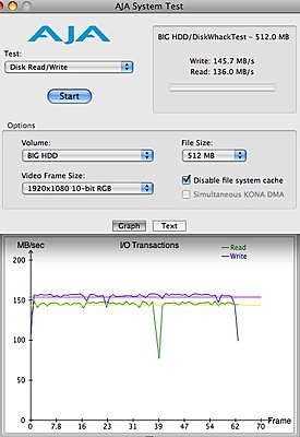

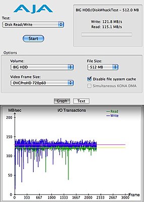

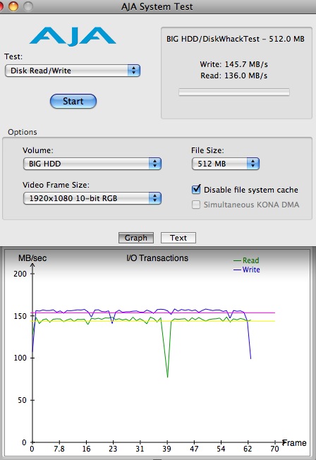

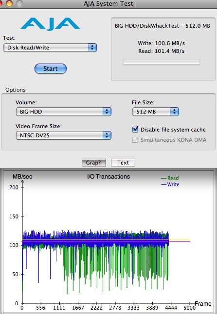

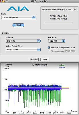

Scott brings up an very important and less-known point: FW and even many USB connections are not very stable, both physically and electrically and are never a good choice for mission-critical connectivity such as video work. With DV and HDV capture many have used this connection to go direct from camera to NLE but the weak connections have also been the source of dropped-frames and bad grabs.
I have a SeriTek ExpressCard adapter with (2) SATA drives in in FirmTek enclosure, RAID-0 JBOD (software RAID). Although there are some Express-card hosts/drive combos that offer hardware RAID it's not as fast as software - interestingly enough.
Enclosed are some tests using the AJA System test which is the most realistic "real-world" HDD speed test for video I've ever tested. Unlike other bare-drive tests used even by places such as Mikes Hardware and BareFeats this utility accurately simulates the load put on any HDD communication just as if it were a real video clip of the codec selected.
There are 3 grabs: One is DV25 (miniDV), DVCPRO-HD 720/60 and uncompressed 1920 10-bit. What may seem counterintuitive is that the uncompressed test shows faster read-write speeds; this is normal because compressed formats actually take more resources going through the I/O pipeline of the HDD. These resources have nothing to do with the actual bit-rate of the video codec. (notice how DV25 has the slowest speed)
Contrary to the glossy ad-campaigns that promise lighting-fast speeds compared to FW800 it's nothing to write home about. Faster than FW800 (which the AJA test typically shows any FW drive max's out around 80-90 Mb/s) yes, but not night-and-day.
I even tested the Magma enclosure (Magma Home Page) and connected my ATTO 42ES to my extermal Fiber array via their proprietary ExpressCard 34 Adapter (8-drives RAID-0). On a MacPro the Fiber array originally tested almost at 380 Mb/s, on the MacBook Pro going through the ExpressCard slot the speeds were knocked down significantly and were nearly identical to what you see here.
The point being, you can't expect tower-like speeds on any Mac laptop regardless how you're connected. The results you see here are the best you can hope for.
